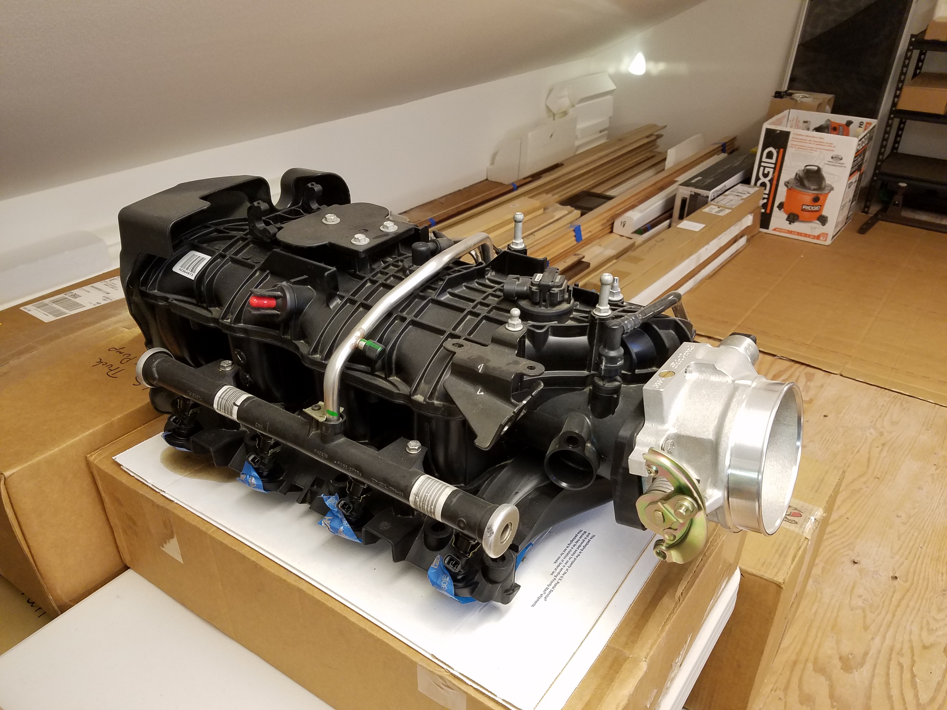

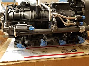

This is how I'm going to run it. I used return style flex-fuel rails with injector spacers and everything clears fine. Injectors are marine 8.1L (stock height). I made little adapters to bolt the rails to the intake but pretty straight forward.
I have a set of these in the shop. Are the 8.1 injectors the same height as the 5.3 injectors?
