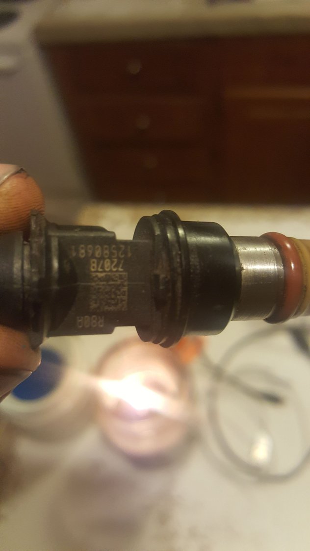

What injectors are they?
GEN 4 stock injectors are going to be larger than 24lb/hr at 58psi.
Of the couple of 09 tunes I looked through they are 29lb/hr at 58psi and the GEN 3 P01 and P59 use a base of 58psi for the IFR table. GEN 4 IFR tables will show 25lb/hr at 3 bar and 29lb/hr at 4 bar.
Talking non flex fuel vehicles here too, flex fuel truck injectors are around 38lb/hr.

I just looked up the part number off the injectors and that's what I was seeing in the pics I'll post pics of the injector,Its the only thing I changed and I can feel it's slower the quarter mile shows it to.

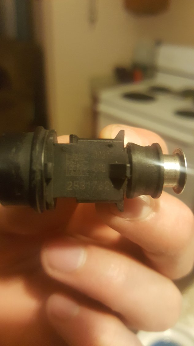

And here is my gen 3 injectors

So no tuning was done?
If so that is your whole problem, the injector flow rate will need to be changed for the larger injectors and the VE and MAF need re-tuning for the larger injectors.
