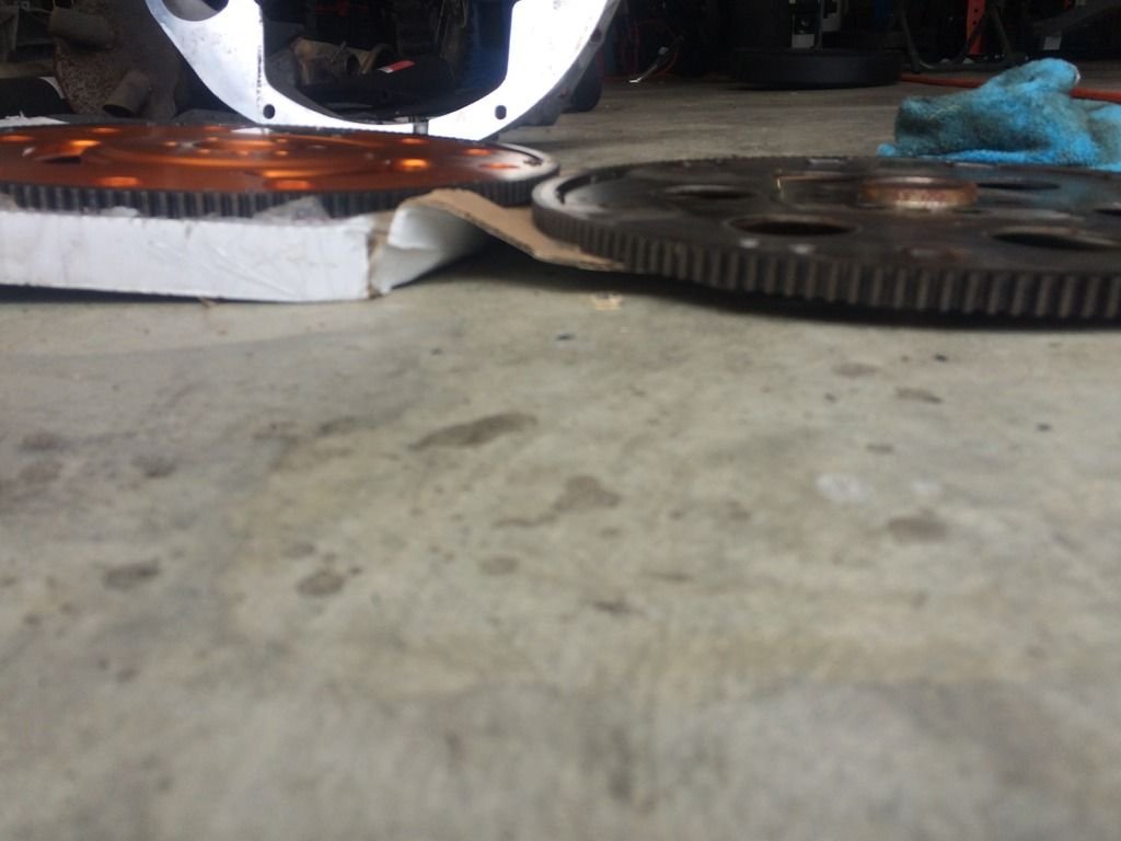

Well after i sent the transmission back to FLT chuck got it cleaned up, found that the case was cracked, most likely during shipping. So he replaced to the whole thing for me i just had to pay shipping. Here is a pic of the new transmission, and the torque converter. TQ'verter got sent back to yank and got new clutch pads also. So after 4 months my truck will finally be under its own power again.
Once i started bolting it up i found out the reactor flex plate i had was incorrect, so i had to take it back out and put the 6.0L stock plate and spacer back in. Only 3 of the 6 bolt holes lined up, that what started the questioning, then after calling yank they said to check the pilot coming out he back of the converter and see it it mates up with the crank. well it didn't. so basically if i wouldn't have found it, it could have been out a center and when it fired up or reved it up would have shaken, possibly shredded my new transmission. Well that what my brain came up with anyways.
new plate in a pretty in there
you can see the space betwwen the pilot and the flexplate and the crank snout
