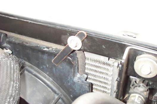

ok here are some pics and you can see how you use the fan brackets and radiator bracket. also a pic of how i held the top but i would like to make a nice piece that goes all the way across. this has been on my truck for like four months and i still have not finished it. i dont like the way the top is held but have been lazy. i wouuld also of coarse paint them.

How is that top bracket holding the fan? How much are you selling them for?

all the top bracket does is hold it against the radiator. the sides is what holdes the fans. i am making a jig now and am going to make a new nicer top bracket. as far as price i dont know yet i have to figure that out still. but just guessing i do not expect it to be bad. just a wild guess prob around 30$... i will get the new top made and take some more pics but it will be a day or two.
