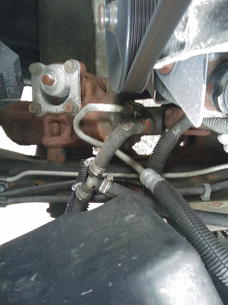

Had the same problem and just spoke with Van from Vanco Power Brake Supply (an expert on hydroboost systems).
He said if your brakes are dragging and you have separated the master cylinder from the brake booster to identify that it is indeed the hydroboost causing the problem (not kinked brake line, old calipers or something else), there are two likely causes:
1. The pedal rod is too long. To diagnose, disconnect the rod from the pedal, then start the truck, if it has stopped dragging, then you need to put spacers in between the brake booster and firewall to space the rod out appropriately.
2. There is resistance in the low pressure return line. It is either blocked, kinked or just isn't flowing well. To diagnose, disconnect the return line and let it drain into a bottle while the truck is running (shouldn't be a gusher, just a trickle of fluid). Plug the connector to avoid fluid spilling. If this fixes it, then that is your problem. If it is T'ed in, then the straight part of the 3/8" T fitting should go from hydroboost to reservoir and the steering box line should be at a 90* angle as it is less sensitive to flow resistance (this is likely my problem, haven't fixed it yet b/c I just found this out today). Another problem is that the T is overclamped and flow is being blocked with the hose clamps. Or, the hose could be old, too small or kinked. He said that the power steering pump should not cause your brakes to drag, so don't haul off and replace that first without testing these things out.
In the picture above, it looks as though the problem was that the T fitting was set up wrong with the 90* fitting going to the hydroboost instead of to the steering box. Hydroboost to the reservoir should be in a straight line through the T fitting.
Hope this helps someone else. I couldn't turn anything up about it. (yes I know this thread is 3 years old)
