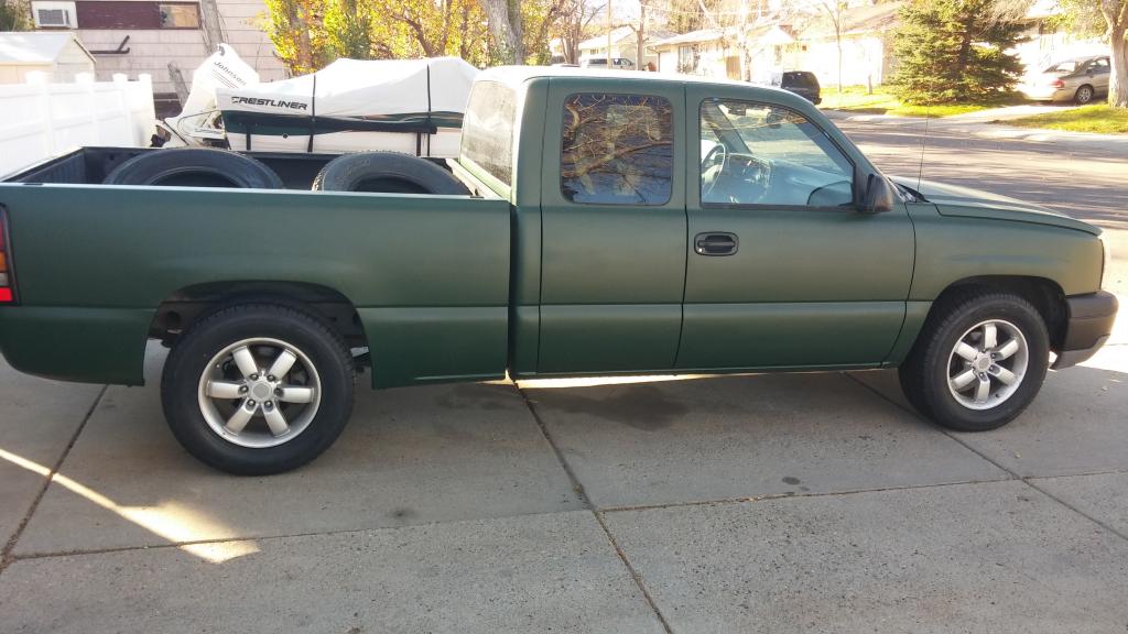

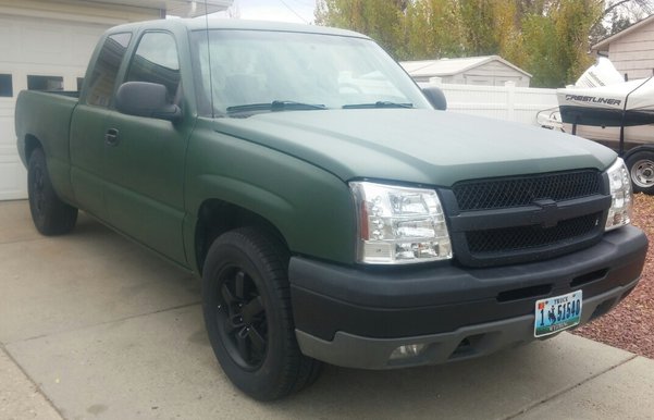

03 Z71 265/65/18, 2500 torsion keys, rear blocks removed and 2" drop shackle, bump stops cut

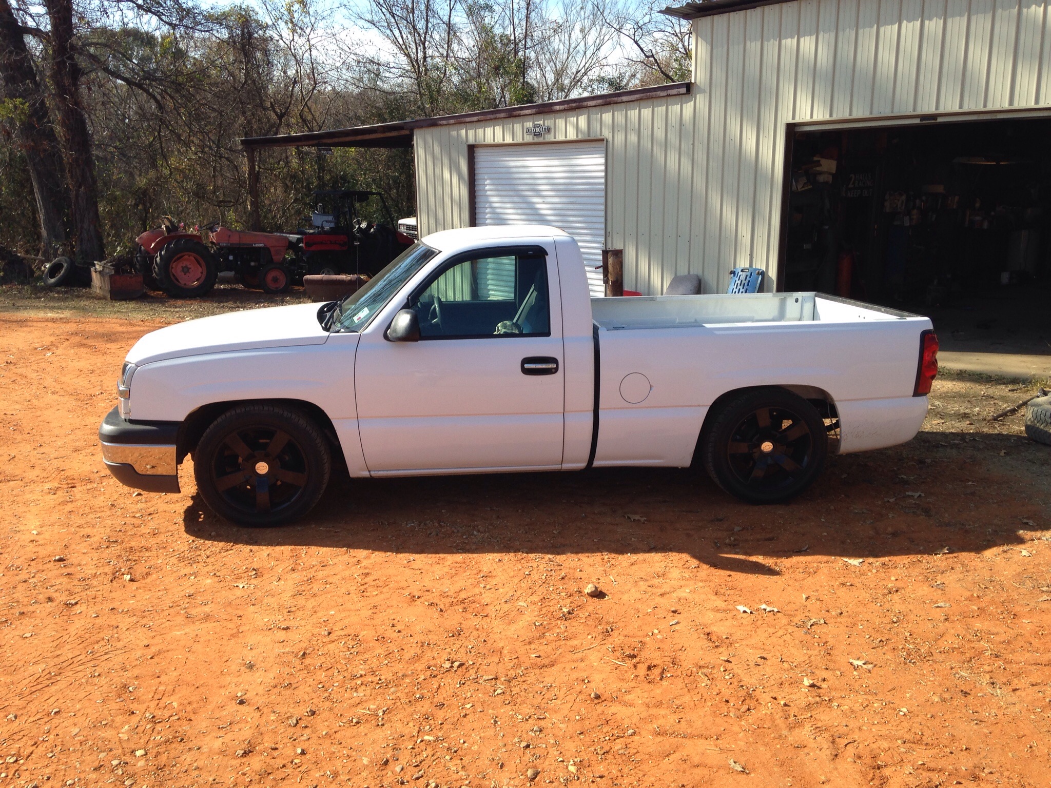

2004 silverado reg cab
4/6 mcgaughy drop
20" silverado SS wheels
275/45-20 Nexan tires
Attached Thumbnails GMT 800 (NBS) Drop Thread Specs and Pics Required-image.jpg

Why drop the 2" on the leaf hanger? Just curious if it was to level it out with the front after installing your drop kit?:
