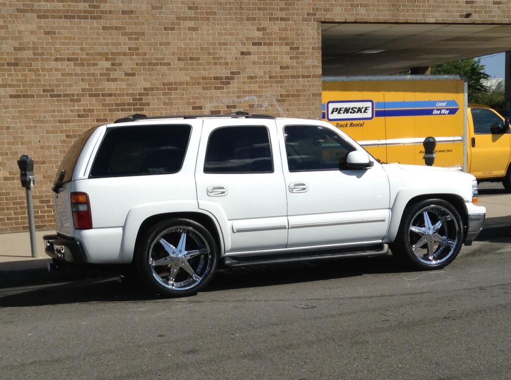

Tony's kit 3-5/6
Djm lower control arms
Belltech sp shocks all around
6 inch lowering spring with 1 inch spacer for 5 inch drop in rear
Spohn panhard bar
Djm rear hardware kit trailing arm extenders and shorter end links.
24x10 dub homies on 305/35 nankang sp7's
Airlift helper bags
