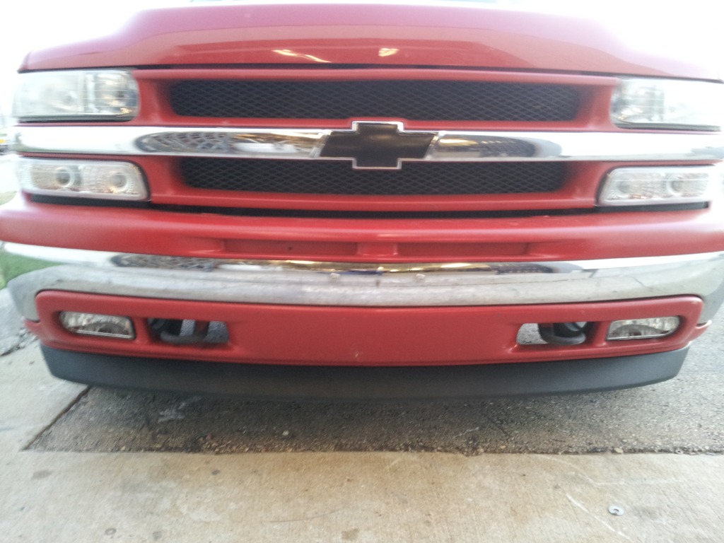

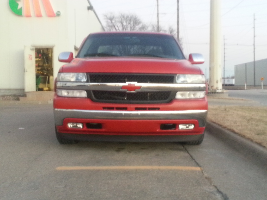

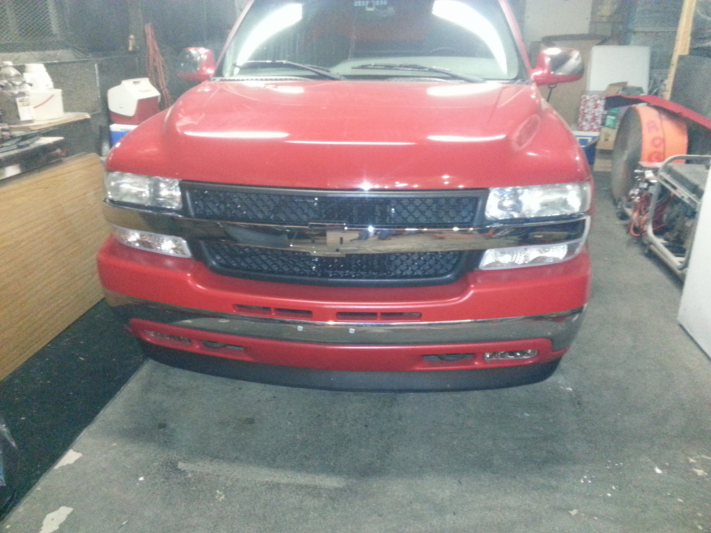

I had to cut frint bumper brackets took out 3/4 of a inch and made 3/4 spacers for bottom brackets worked out just fine
