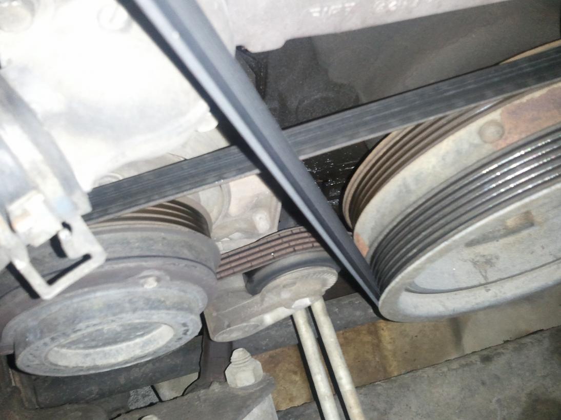

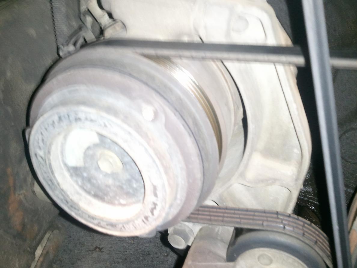

The bracket mounts to the bottom pass. Side with three or four bolts (which I also have have) flatter side to the motor and the compressor tucks into the mount I guess you could say and the tensioner which I have some of too will mount to the front bottom part of the mount...give half a hour and I will take a pic for you
Old Oct 17, 2011 | 11:07 PM
robert85's Avatar
MASS seller approved
iTrader: (24)
Joined: May 2011
Posts: 395
From: Gulfport, MS
They are little crappy but I was trying to show you where the tensioner goes and the how the compressor kind of tucks into the mount

Hey Robert thanks alot i appreciate everything and the offer, but i called the junk yard where i got it from and they said i just have to go pick up the parts i don't have and need. If i go and they say something like oh well we don't have them anymore ill gladly get them from you.
