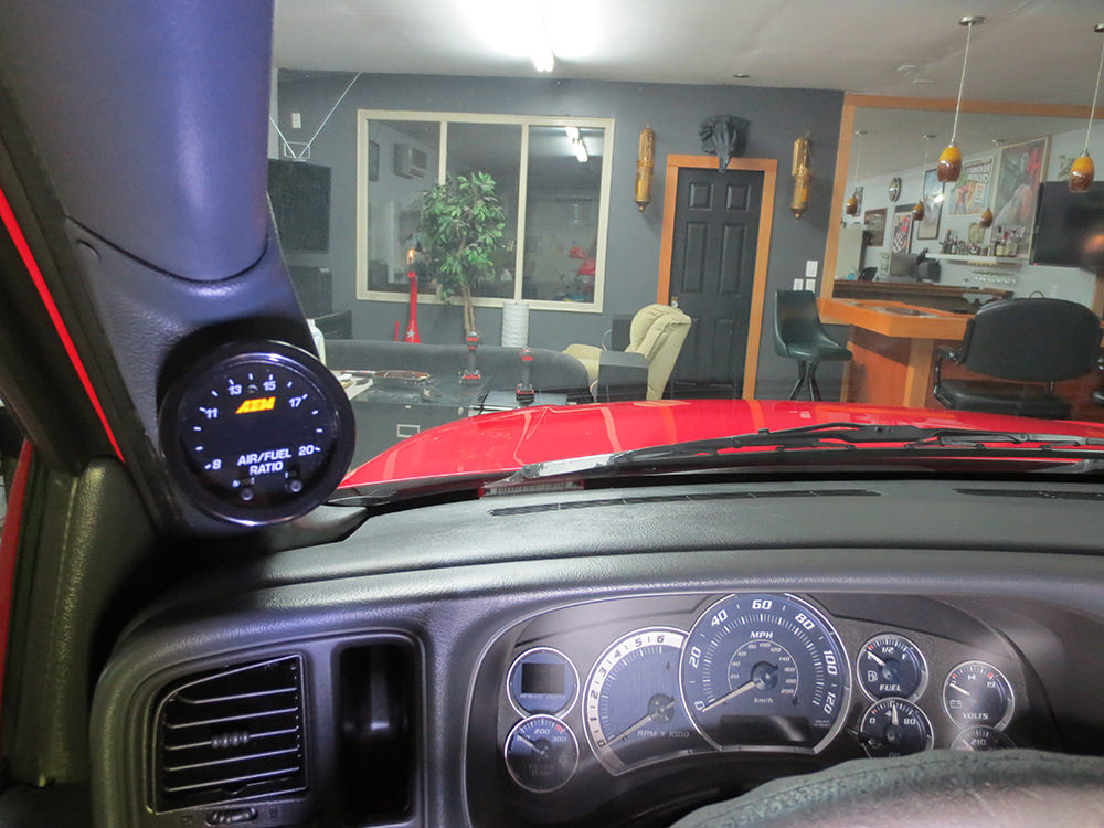

If those are Iridium plugs the gap should be pre gapped at .040 carefully check the gap and don't fk up the small wire trying to change the gap. With a roll of the dice mail order tune throwing lean codes... my advice is to install an AEM wideband (30-0300 X Series) to monitor the air/fuel mixture. After all the work and money you don't want to toast the motor now. I've dialed my tune in spot on and still keep an eye on WOT hits (12.5 air fuel ratio) making sure nothing has changed the air/fuel mixture.
