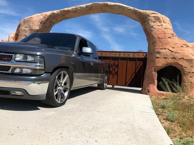

Old May 23, 2019 | 12:52 PM
01SilveradoJakee's Avatar
Joined: Sep 2015
Posts: 299
Likes: 6
From: BFE Arizona
Springs up front and shackles and hangers in rear. 2/4 drop with some bilstein shocks. Even with 22s still rides great
