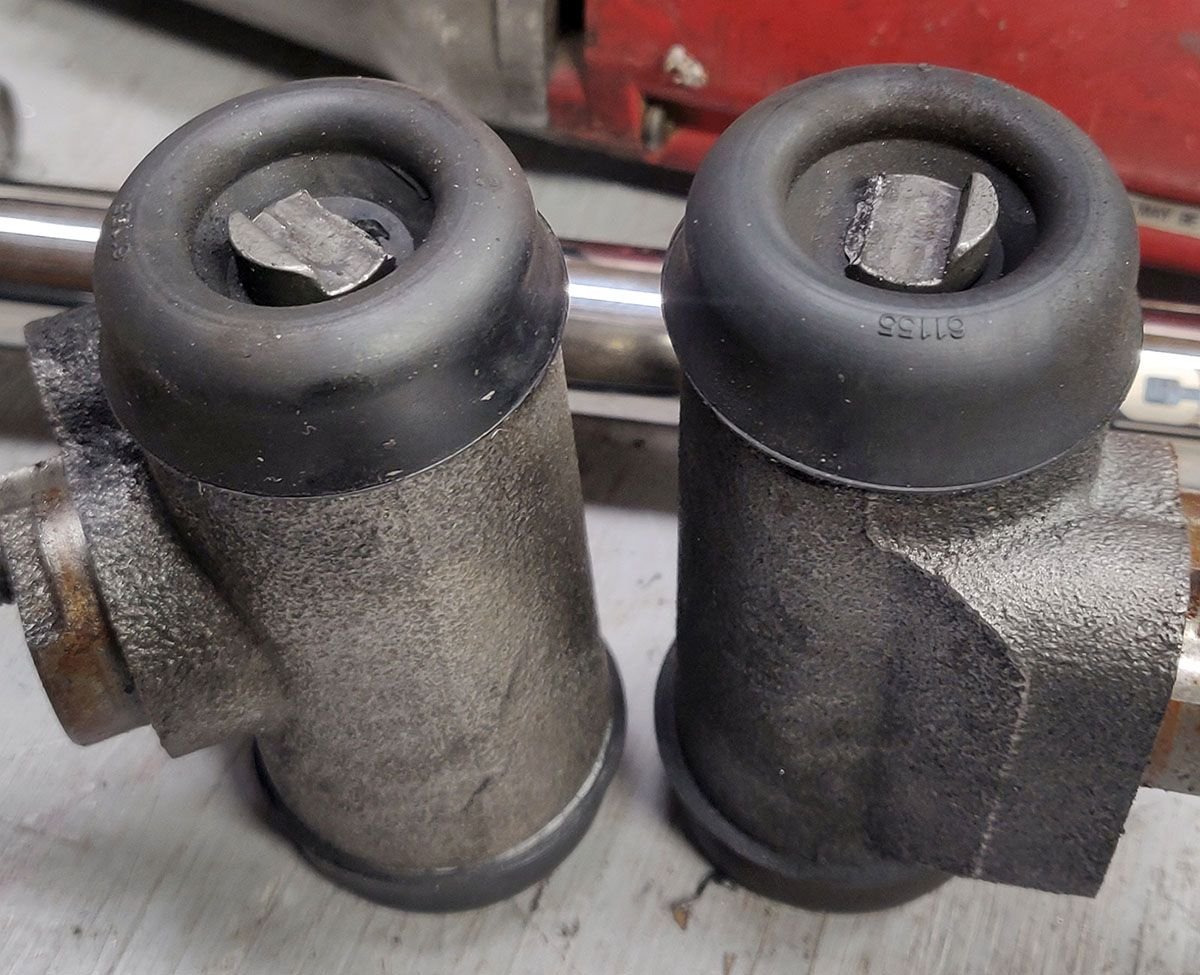

A little update, I started getting a rear drum shudder. Not like a pedal up and down out of round drum. High frequency low amplitude.
So I put her in the air with tires off and see hot blued drum. Pull it off and see a shoe holding tab on the new wheel cylinder is broken off and the shoe leaning out ward a little.
OK, I figure I found the shudder but since shes in the air I look and find the other side the same!
I didn't do it. I have the special t-handle spring tool, it all went well as the second time with new wheel cylinders. China AC Delco?

Probably not; more likely, a ham-fisted "mechanic" visited it before you.
