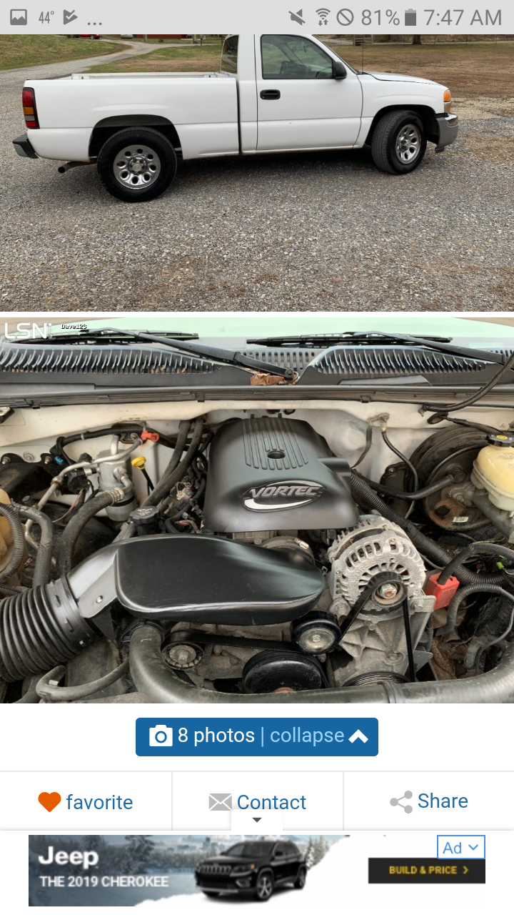

I ran across a deal on a 06 4.8 truck for my younger cousin, I payed 2k for the truck which to me was a steal. The guy I bought it of off had it for 2.5 years and put over 40k miles on the truck. The truck don't make a noise and runs and drives great. But the abs, check engine, battery, and security light comes on in the dash. And when this happens all the gauges beside the tach and Speedo stop working, The radio also shuts off. But every once in awhile the lights go off and the gauges and radio start back working. Then it'll chime and they quit again. He put a new battery in it and had the cluster rebuilt but it didn't fix it. Wonder if it's a corroded ground, posts or the ignition going out? Soul like some if you guys opinions on this. The trucks really clean for the money.

I just noticed something. I see some one has already added a redundant ground. I also noticed the frame rail appears to be rusty just below it.
Not sure what other work has been done but the sound pad is missing off the firewall. You maybe in for a real treat

I'll check them out this coming weekend, as for the frame it is dirty but the trucks solid. Definitely made sure and crawled all around it. The guy did say he bought the truck with the wiring harness messed up and he put another one it. But just over a month ago it started throwing the lights and stuff.

Any chance this is someone’s bastardized v6 swap?
Run the VIN and see if it’s a true v8 truck.
