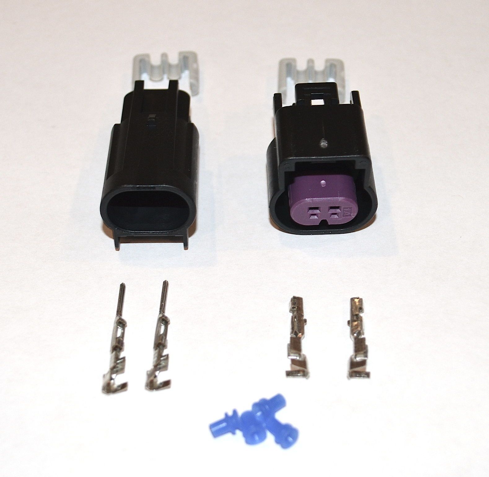

Yeah, best bet is to not cut any wires, but like mentioned above there are a couple wires that go to the ECM. If you have time, unplug the large connectors from the ECMand depin those wires. It will make it simple to put them into your current ECM. I cut the wires and ended up having to rebuild the harness.

In case you do miss pulling the PCM harness, like I did, this is the plug you need.
Delphi GT150 Series 2.
