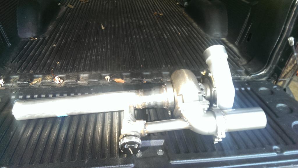

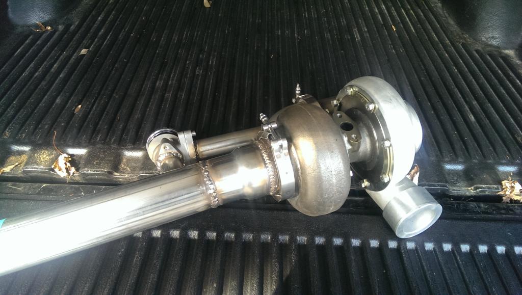

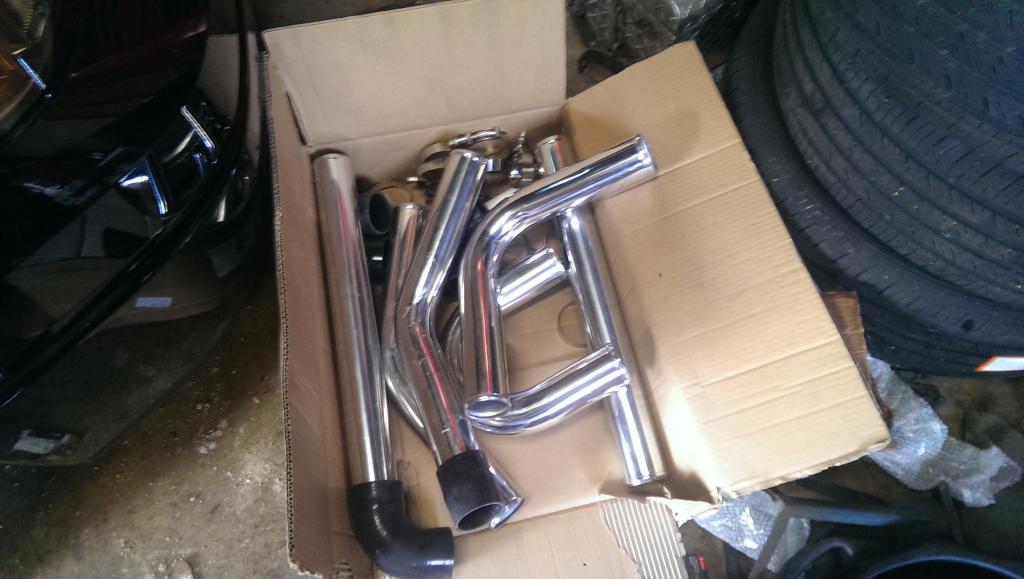

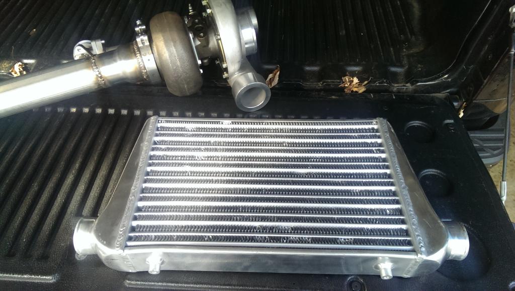

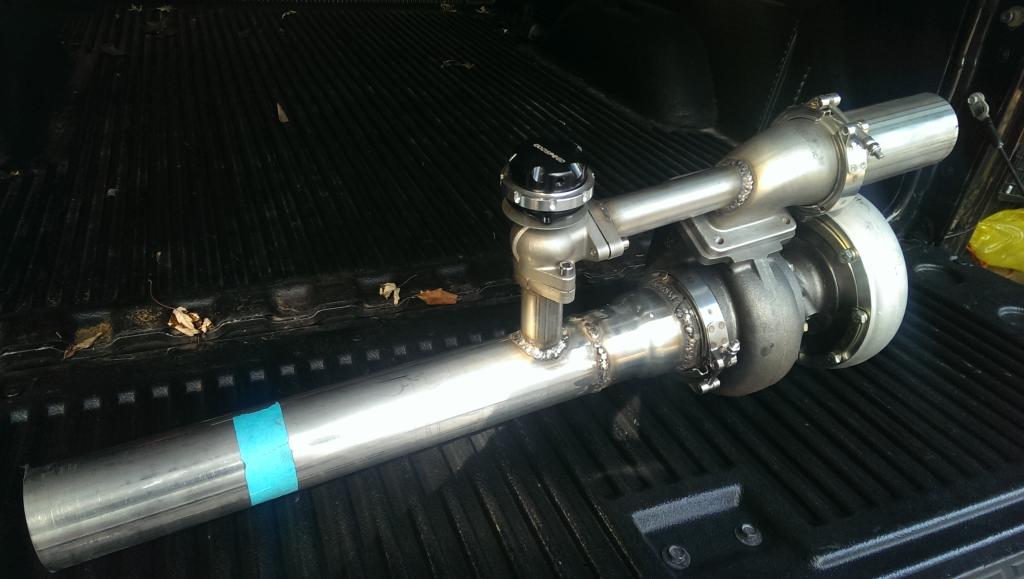

I decided to go a different avenue with my truck. It's a gt45 78mm eBay turbo, Godspeed 38mm waste gate, custom fabbed stainless piping, front mount intercooler, ic piping (bought two universal kits). This kit will mount up right after the y pipe, cut your exhaust off six inches past the flange and slip the down pipe over it and weld it up. I'd take 1500$ shipped to the 48

Just fyi, the waste gate is mounted backward, the face of the valve need to have the exhaust flowing at it.

^^^^ yes good catch KB

Oops, not a problem. I'll have that fixed in a couple days
