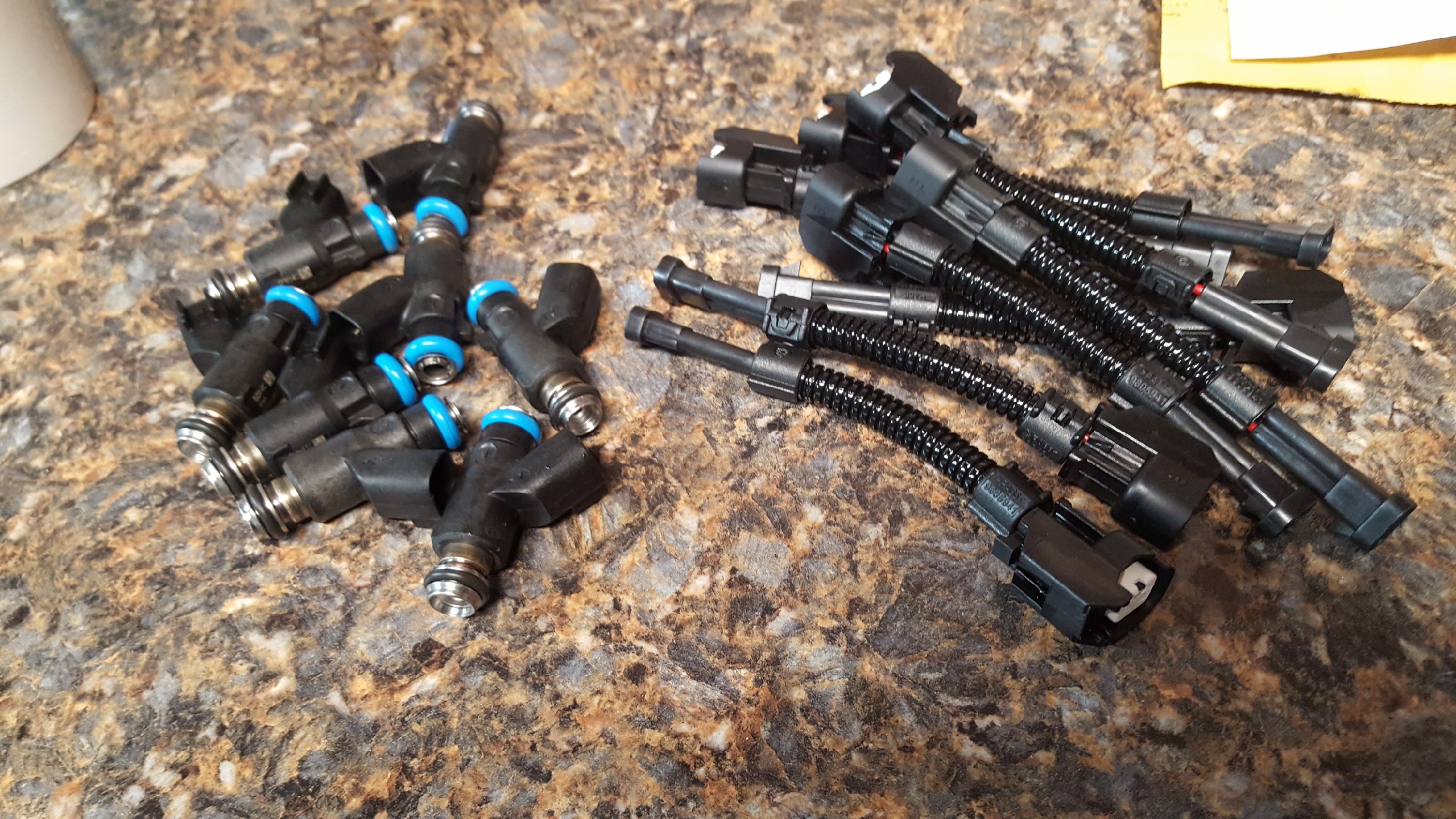

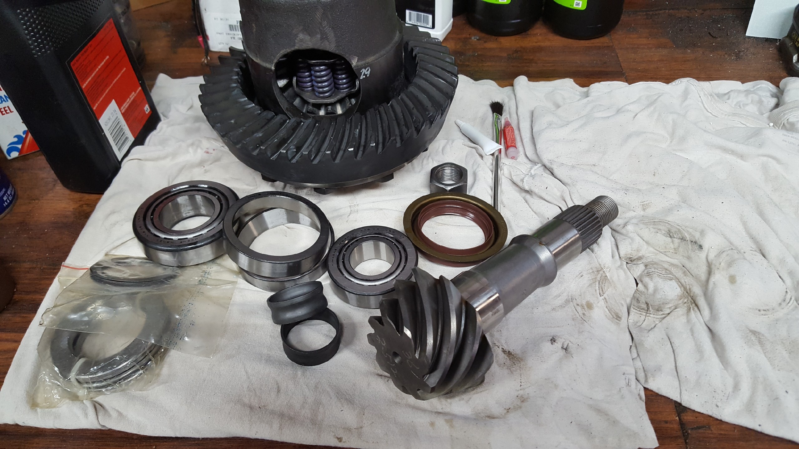

I cant seem to win with this truck. Randomly started getting some gear whine under load from the rear end (motive 4.10s, stock open diff). Pulled the plug and there was some shavings. I figured I dont like the 4.10s with the 4l80e gearing so lets upgrade right? Ordered up an Auburn posi and motive 4.56s. Did the install and didnt find anything obviously wrong inside the diff, super happy with the difference though, and it tamed the converter down some for driving and towing.
Now that that $700 is gone in the wind we are good right? Nope, truck has been running like crap lately. I had installed some flow matched decapped injectors due to the stock duty cycle hitting 130%. All seemed well for a few weeks then it went bad. Fearing a faulty injector I ordered up some flex fuel injectors and adapters. Installed them, started tuning and its running worse! Something mechanical must be wrong and i bet its something simple. Time for more digging.

Fast forward, found a plug wire grounding out to the dipstick tube. The fix: regap all plugs from 60 to 35, and move the dipstick further away. She's running like a champ now.
Now I guess I'm retuning it with the new injectors and now no misfire.
