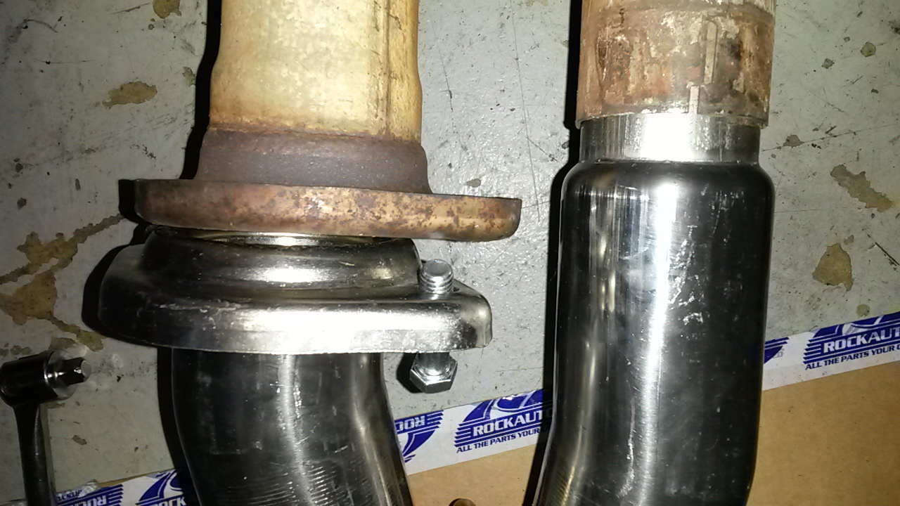

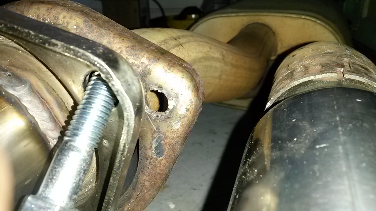

I ordered Kooks LT + catted connection pipes for March 15. Finally got them the other day after many delays and being sent the wrong product.
Get them and it doesn't fit at all.
The only thing I could think of is maybe if I cut the two pipes apart (they are welded as one unit) then maybe I could get it to fit. BUT the problem is that it looks like the flange is rotated and angled wrong so it might not help and I would hate to not be able to return this.
Well it looks like that family trip next weekend might not happen or I might have to get a rental.
Has anyone ever seen this issue before??? I couldn't believe my muffler is bent because the factory exhaust goes together perfectly.
Kooks part number 28523200
Kooks 28523200 01-06 1500 V8 3" Catted Connection Pipes

I contacted the vendor I bought it through but not Kooks directly. I emailed Kooks before the purchase to verify the part number works so this sucks the big one. Took my muffler and con pipe to a shop today and the guy said he wasn't comfortable fixing it unless it was in the truck but he thought he could do it. Would just take time to cut the pipe up and reweld. Plus $$$$ that shouldn't need be spent.
You wouldn't happen to have measurements on your exhaust and the Kooks part you bought would you?
When are you planning on installing?

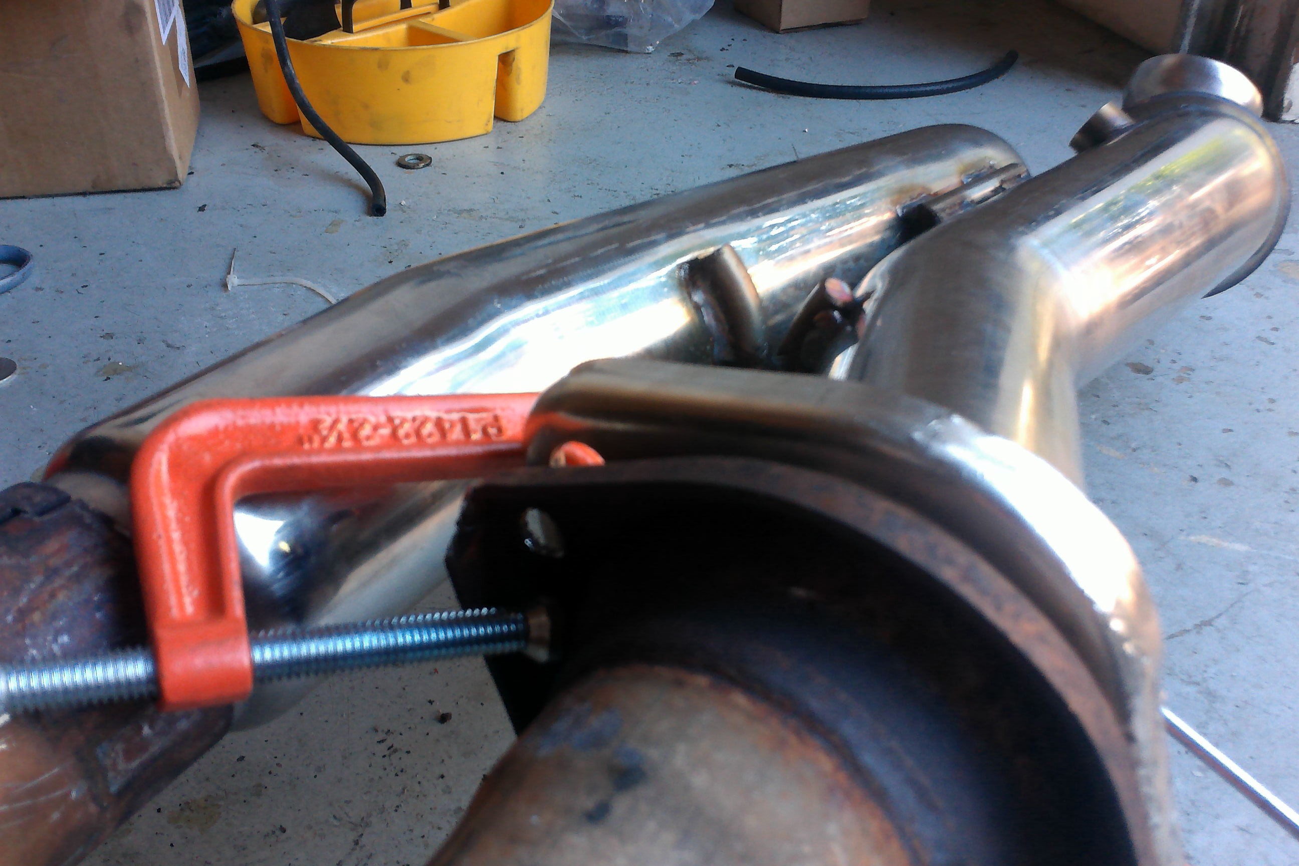

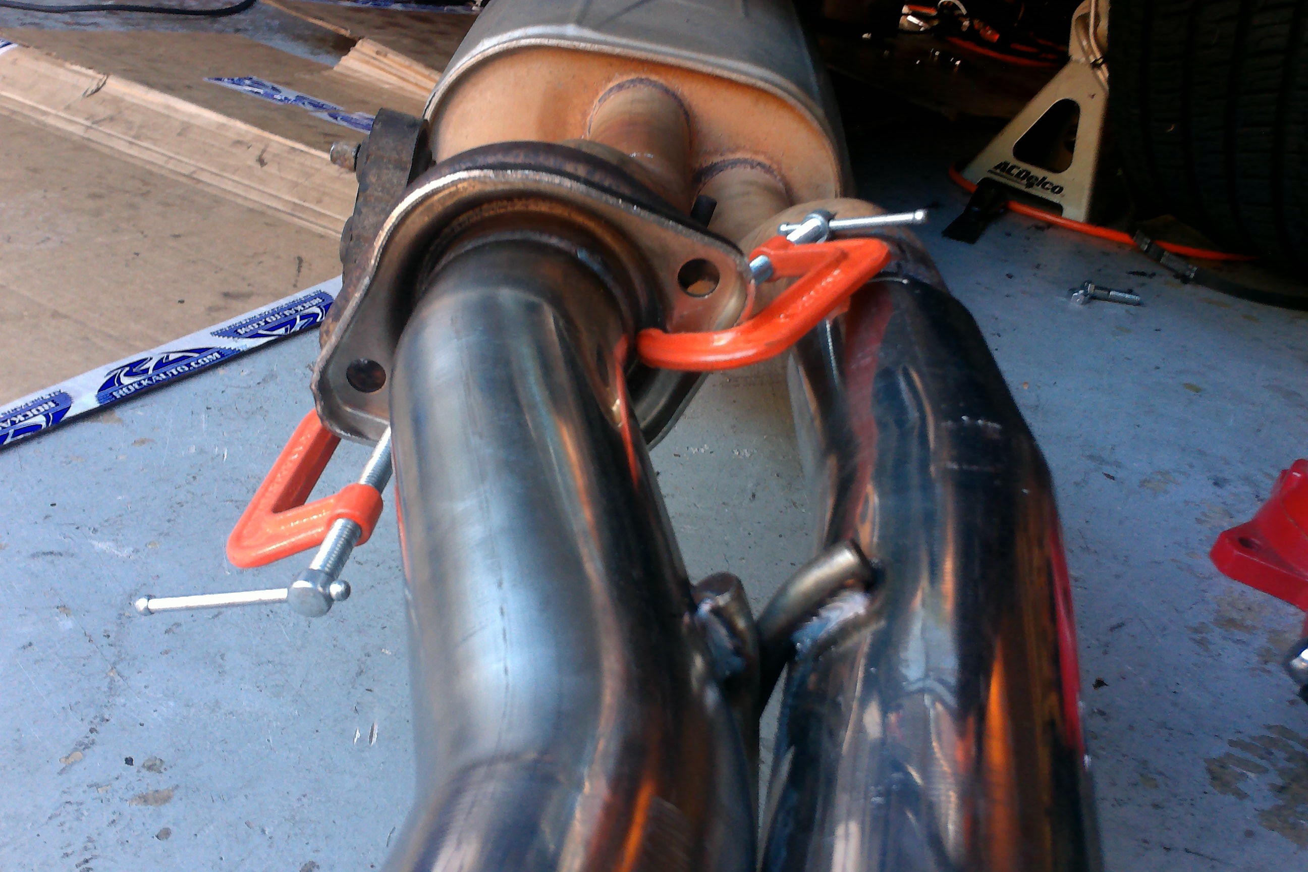

I was looking at mine last night and thinking of using a BFH to close the gap between the two pipes. Bang on the fixed flange till it gets close and then cut the flange off. (Dirty secret: the fixed flange is actually steel and not SS, I used a magnet to verify.) Use a band clamp to try and seal the pipe. The slip fit part works ok. Then I can drive it to an exhaust shop and have them fix it.

Update:
I was able to beat the pipes together with a BFH. But let me tell you it isn't a great fit. The flange is warped and I am upset it isn't SS. That means it will rust like crazy up here in PA, DE, NJ, MD, etc. Not even sure it will seal. But the bigest thing is that the holes still don't line up at all.

Sounds like there jig got messed up.
