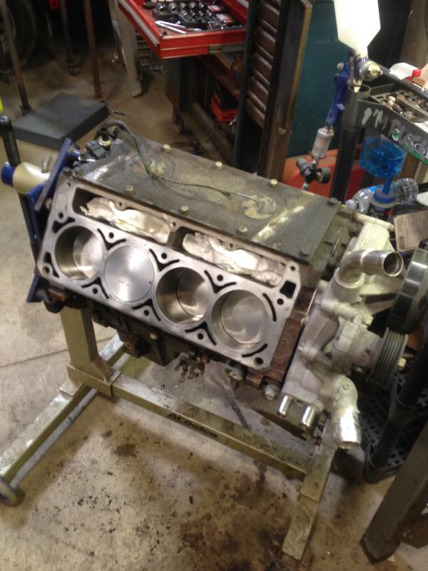

Well motor started puffing smoke when starting so I found the new donor motor- lq9 - figured I'd do head gaskets while it was out, and look things over

That's really clean inside. What did you use to clean it?
