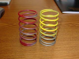

Originally Posted by TG02Z71
The spring does not sit on top of the boss, it sits down on the outside of the boss on my wastegate. Is this wrong or right??? Who knows, STS has all these pictues as well as more. they are sending me a new spring this week, I hope it gets here soon!! I did post all the lenghts and diameters for the spring in this post..... I think, I'll look back to check.
Hate to say it, but that sounds like the .8 bar spring (12 psi). I'll measure my .4 bar tonight and post its diameter to be sure.
Well STS is sending me two springs to try. A .3 bar (3-4psi) and a .4 bar(4-5psi)

Hey man, I finally remember to measure my .4 bar spring diameter -- it's right at 1 7/8. As I recall the .8 bar was a noticably bigger diameter. I can't check it - its in the wastegate up at the shop
Let us know what you find out with the tune and the new spring.

Here vare the new springs that STS sent me. The red is the same as the one I have now...supposedly, the yellow is the .3 bar good for 3-4psi. I'll be trying them out soon, keep you all posted.
