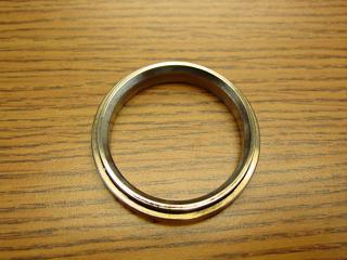

I just thought of one more thing that you didnt mention. When you put the wastegate on, did you seat the ring between the flange and the wastegate. I dont think it would cause the excessive boost, I'm just thinking out loud. The ring should seat in the bottom of the wastegate before installing.
I'll double check that but I think it good.
I had some work done at a local exhaust shop and they took off my wastegate and promptly lost the seat. I can tell you from experience, you won't get excessive boost from this I got 4 psi
For clarification are you taliking about the stainless steel ring that looks like this??
