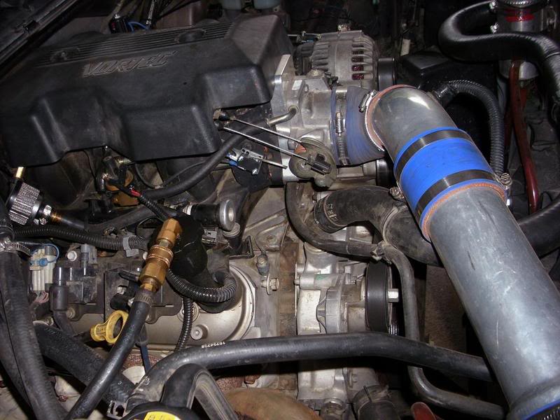

While reading this i remembered that i still have those Solnoids from the STS kit..
Im thinking about running the 'noid to the Hobb switch so it can pull vacuum on the Crankcase until i get in boost then it opens up and lets the CC breath to the atmosphere through a breather. also run a catch can so no oil should go into the intake?
Sound good?
