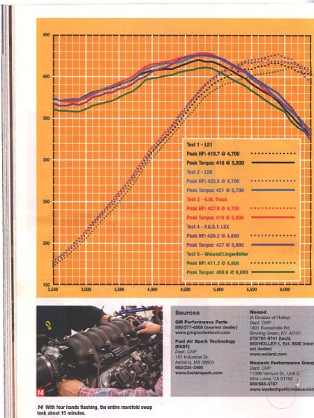

Try this thread out.... actual testing here... In the picture I posted of the dyno test, the truck intake actually stays a head of the LS6 manifold ever so slightly. But there basically dead on with each other. Hence no real advantage or gain. I would really like to see the new edelbrock manifold tested against these and the TBSS mainfold. I know the TBSS shows a gain over the stock truck and I believe thats partially because it uses a 90mm TB rather then the factory 78mm TB that came on our trucks....
https://www.performancetrucks.net/fo...d.php?t=397720

Ok. I actually read on another site where some people are getting gains and others aren't. It all depends on your mods. To me it's not worth a chance. I am just going to go with guarunteed mods.
