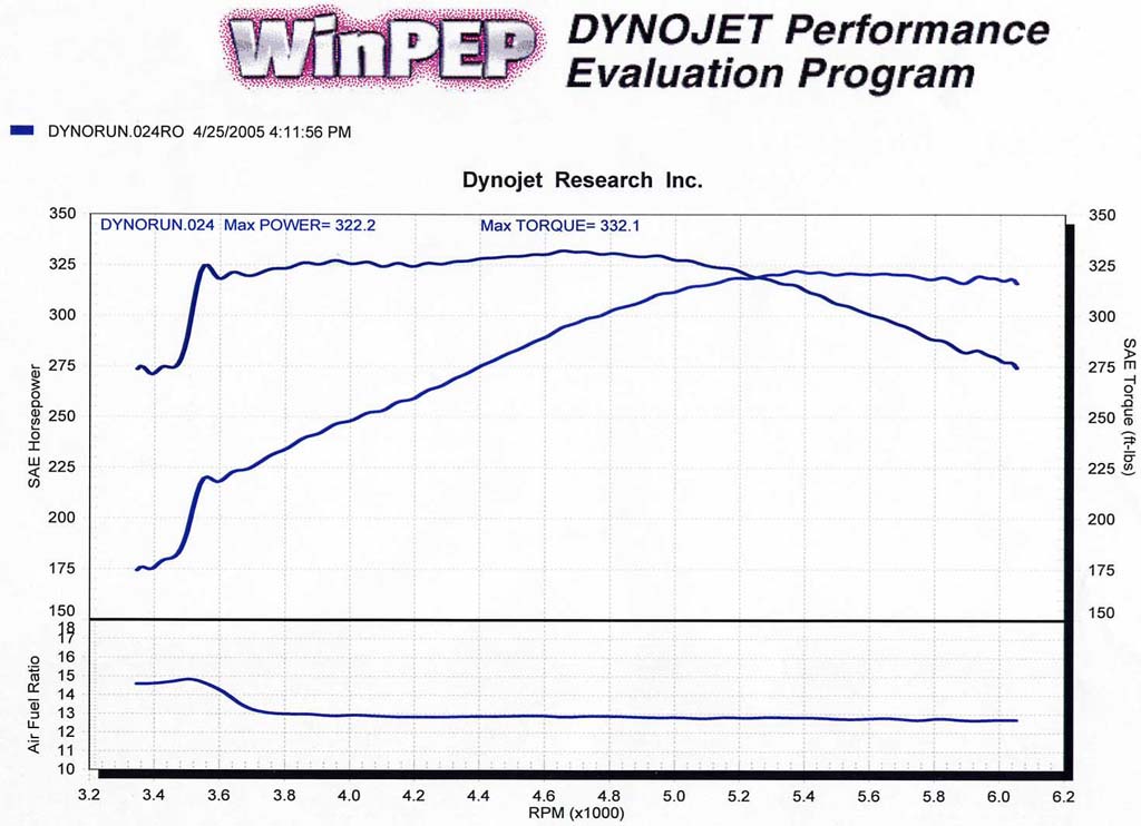

Well I installed my CAI and LS1-Efans and decided to go ahead and take her to the dyno to see what I gained and check if my AF ratio was still ok after the CAI. We made some runs and had to lean her out and finally got the AF ratio to 12.7-13.0 During some of the runs I was seeing KR and the pcm was reverting back to the low octane table. When we finally got everything dialed in she made 322 Hp and 332 ft-lbs Torque. I wasn't to happy because after CAI and e-fans I only picked up a peak of 5 HP and 4 ft-lbs of torque. When I get a chance I will scan the Graph and post it up.

Here are the graph's. Second graph is the before and after E-fans and CAI. I don't have any track times yet but I am trying to go this sunday, but its only an 1/8th mile strip. Will see what I can pull off on street tires.

Looks pretty good to me. Nice broad power band. Where did you get the dyno done?

it may not show much gain, but that's a pretty decent showing on the dyno. fairly flat torque curve with good overall power. not bad for a 5.3.
