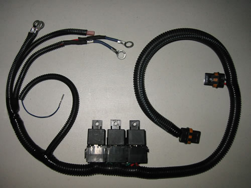

abbo7, here is a pic of the harness, it's very simple but made very well. I went ahead and took a shot real quick. It's kind of small but you get the idea. It has an a/c tap, pcm wire, ground, power and of course the ls1 oem connectors.
When the engine reaches the on temp, both fans come on low, while both fans are on low, if you turn the a/c on, but fans go high. If the engine cools down and reaches the off temp, one fan stays on high as long as the a/c is on.
Power is provided by the red junction box on the side of the engine, ground is the 10mm bolt that holds that box to the alternator bracket, and right between those two connection points are a group of wires, open up that loom and find the dark green wire, use the supplied connector to tap into the a/c clutch wire.

It might be simple, but I can tell you it looks a whole lot better (as a package) than the one flex-a-lite sent me. I am really looking forward to getting it. I just installed my trans-go, and need to test it out
BTW, I like the option of when the A/C is on and when the fans cool down, it only runs one fan, that is good for the interstate crusies.

thanks for the coments abbo and marc, this harness will not fall apart, all joints are soldered and crimped and made of txl rated wire. (except for the pcm wire, i couldn't find it in txl so it's sxl or something like that) but this wire will never melt, you can hold a lighter under it and it will not blacken or melt like that cheap auto store stuff. i use fusible link instead of fuses, so it's a cleaner install, and if one happens to open up because of too much amps (from a shorted motor) just give me a call and it's easy to replace. Just like on the starter wires, they use fusible link. FL is a lot harder to blow than a fuse, but it will open if it is overloaded.
