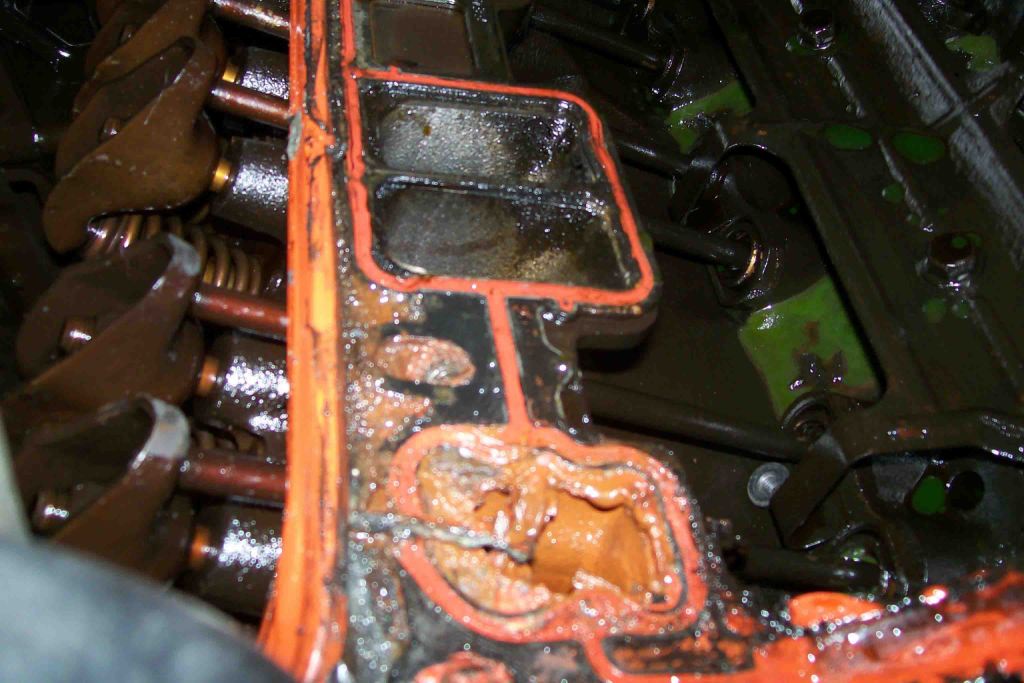

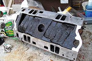

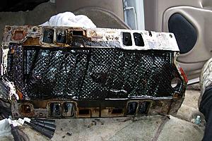

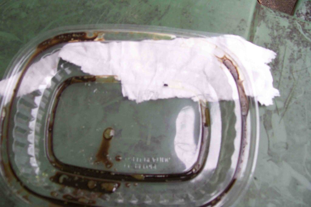

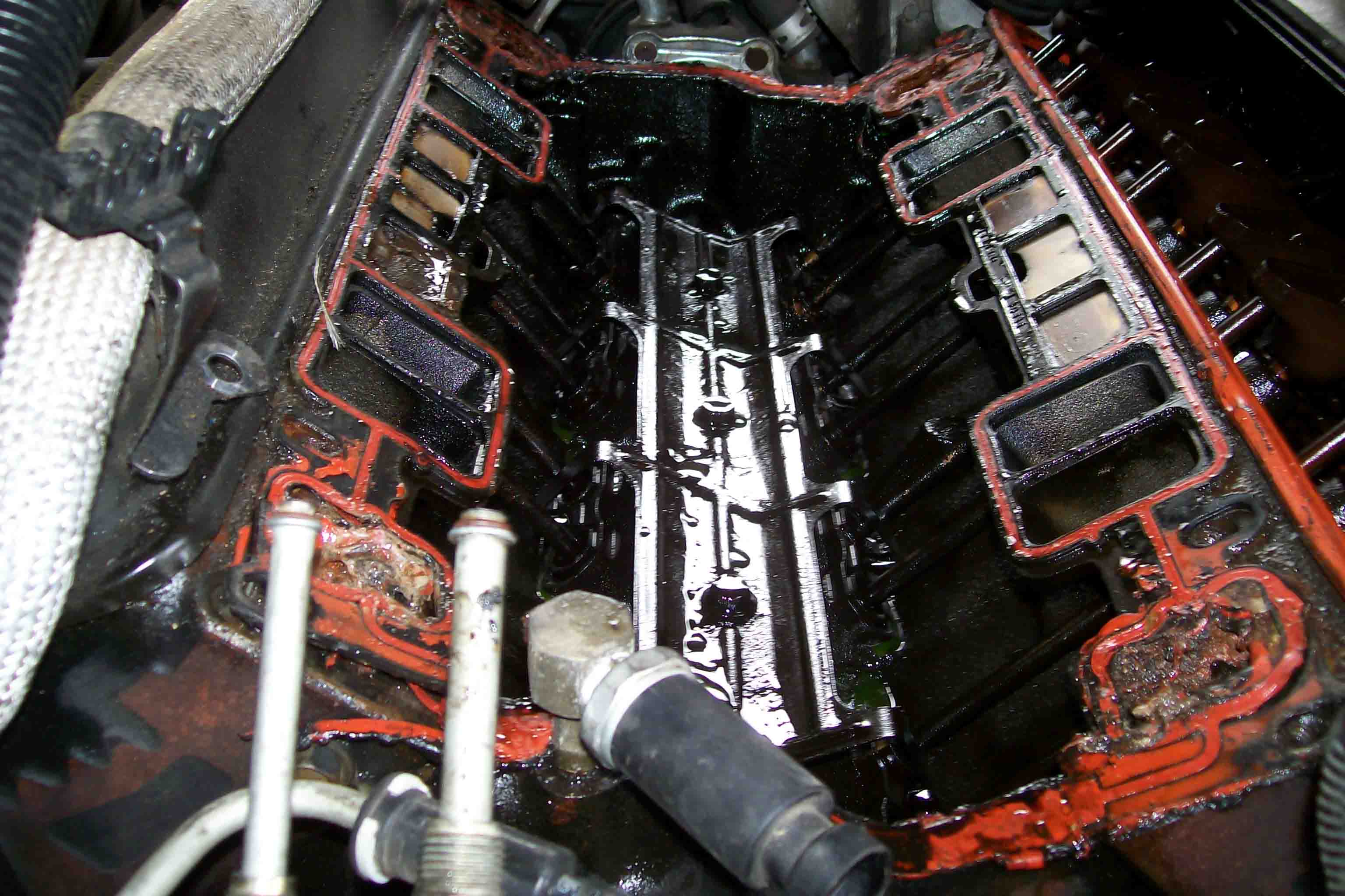

so you Guy's think I could have actualley fixed the dissappearing antifreeze w/ mannie gasket swap. I drained a little oil and the antifreeze was in oil. heres a few images of under the mannie.
all I'm lacking is to figure out have to reinstall the distributer to test her out?

Ugh yes, those were the original plastic gaskets (or original type used to replace prior failed ones) - hopefully you didn't replace with same?
Full oil change is needed, any coolant in there will create an acidic condition with the oil and eat your bearings. Another change sooner than normal once you're up and running would be wise, too.
Those gaskets are ugly, so I'd say you found the issue. If it still continues to lose coolant then you could run a chemical block test to see if there are combustion gases in the cooling system.
The distributor has to be set using a scan tool that can read the cam retard angle. You want it within +/- 2 degrees of zero while holding RPM's to at least 1,000 for a good reading.
