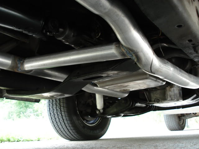

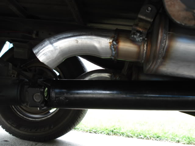

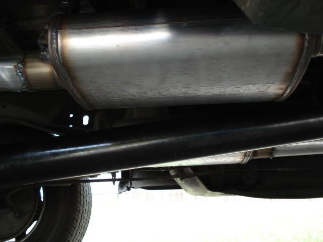

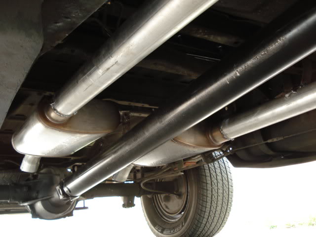

Got exhaust done on yesterday. What ya'll think?
