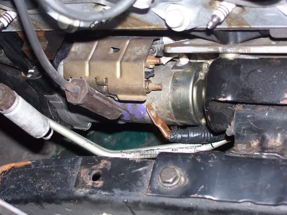

Here's some of the wiring repairs from a goof-up during the first mock up. They're not the clearest, but you'll see the "uh oh" that had to be repaired.
Not much to look at yet though, once I get the intake, coil packs, PS pump, belt, etc.. it'll be worth a look.
I have had a bunch of repairs to do to my harness, the one I got was cut right behind the oil pressure sensor, so I have been stitching in some 4L60E wiring from a cut up LT1 harness, VSS, and I need to add some leads for the front O2's. I hope to get that all patched tonight, and then I can concentrate on the power distribution, guage and ALDL wiring.

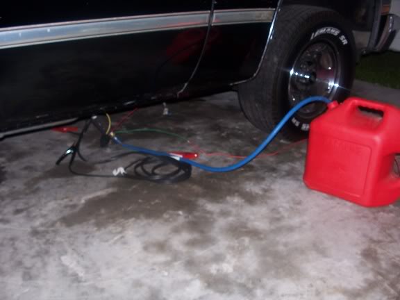

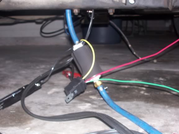

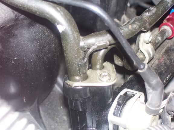

I go outside again to prime the fuel setup, and what do I hear? Liquid hitting the ground... thought it was rain, but it was fuel. :shock: Strong odor coming from under the truck. Disconnect the hard-wired fuel pump, and notice fuel coming from the rail's regulator area (I think that's what it's called). I then let out a Charlie Brown AAARRRRRGGGGG!!!! *sigh* I'll disconnect the return line, and put it in the same tank I had the feed line in (dunno why I didn't do that the first time).
Here's some pics:
For those that dunno, my motor was siezed due to sitting so long. Had to use some special lube oil (WD40) to get things loose. I'm taking a break right now. Seems I'm missing a power lead to my coil packs cuz my plugs don't spark. Stay tuned...

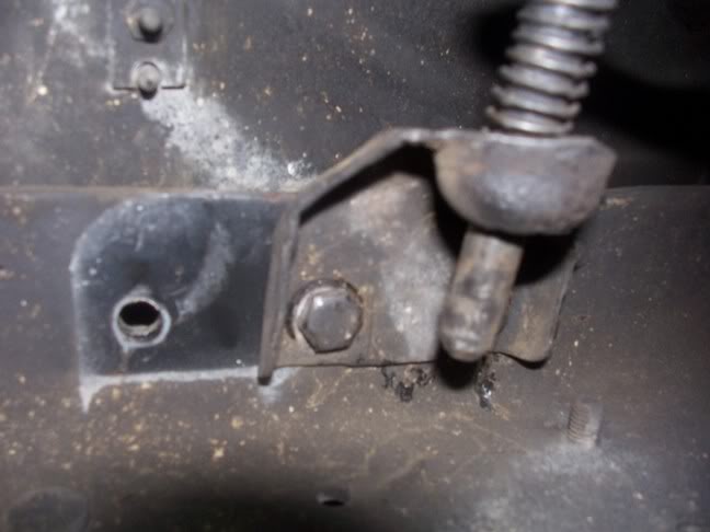

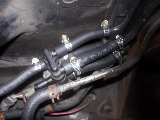

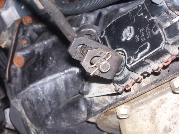

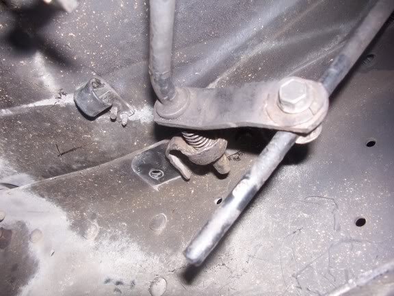

Got a few things done. Attempted to permanently mate my fuel return line to a hard line using compression fitting... nothing but leaks (even with teflon). Oh well... Cleaned up wiring a bit.
Gonna end up removing these later... Don't think it's high pressure hose (see words on hose).
Column Shifter is all set.
Took me a while to drill through the chasis... at least til I got a real sharp bit. New bits are bad ***... they make quick work of a hard job. Been working on the truck for over 8 hours.

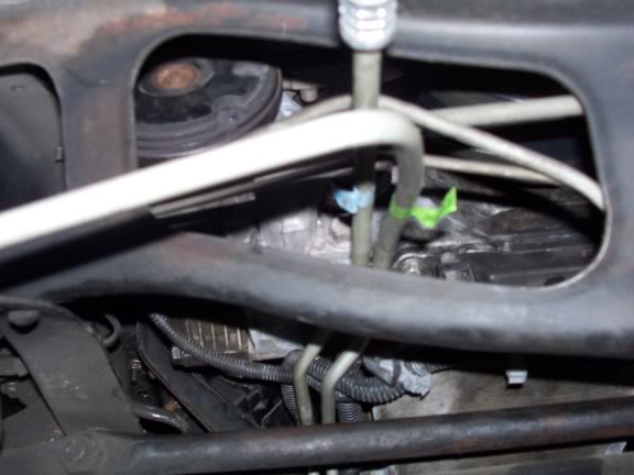

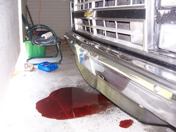

Well... as Matt & Nick already saw... I had my trans lines done, but the auxilary cooler was cracked in two places.
Got some J-B Weld on it now. Will find out how well it holds up.
All was good, til I started the engine, and proceeded to add trans fluid. Here's the end result:
Trans cooler was a busted one... may try to JBWeld it sometime next week.
