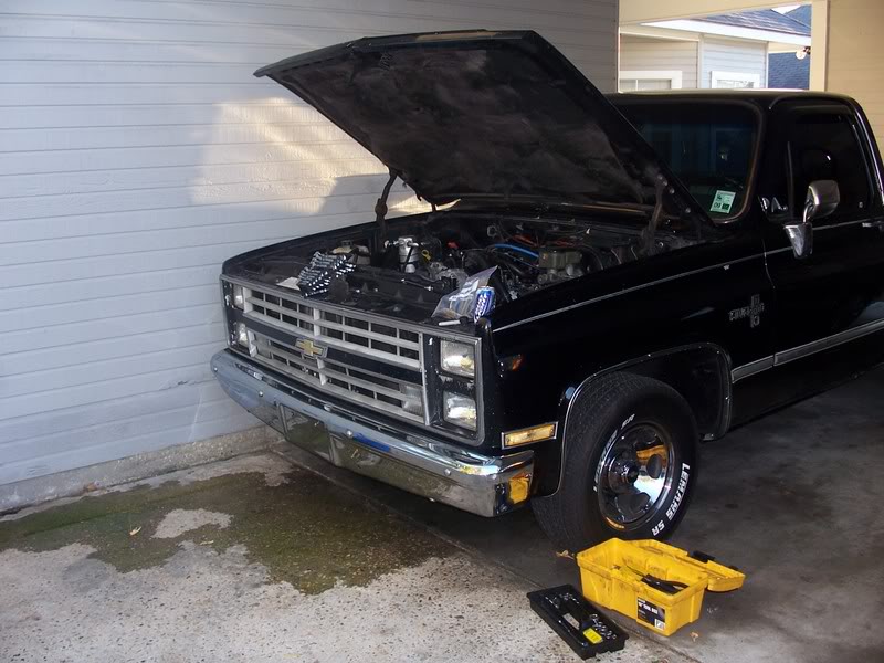

Like Nick... I'm not one for "how to's", but here's some pics and short descriptions of what was done in sequence:
Engine coolant drained from truck (need to find a cleaner method)

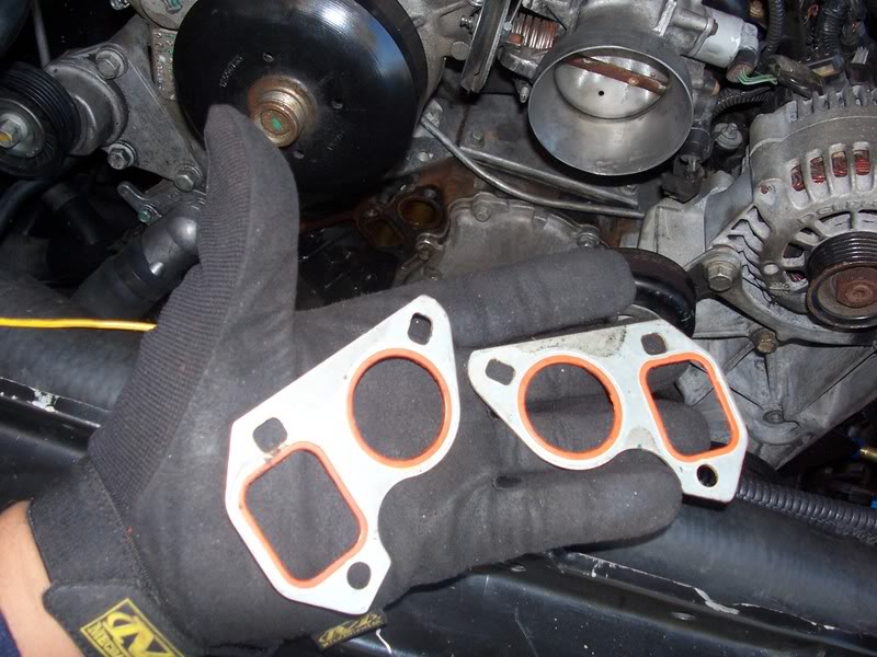

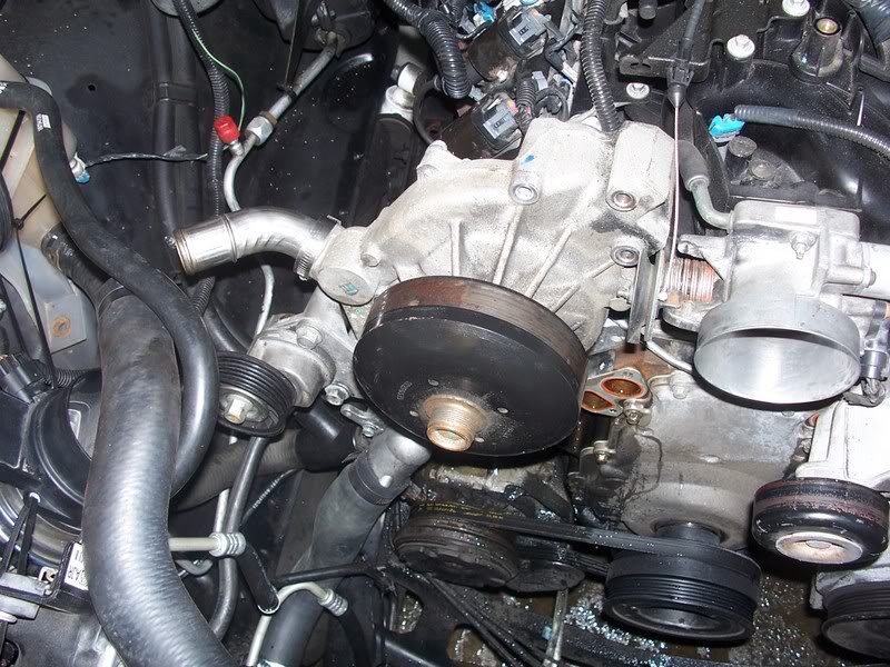

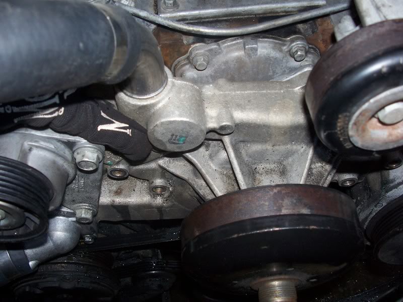

Water pump gots ta git (bolts tag'd & bag'd in a zippy)... Six bolts to remove
I thunk I betta pull dem gaskits too... fer safe keepin

Water Pump laid to the side

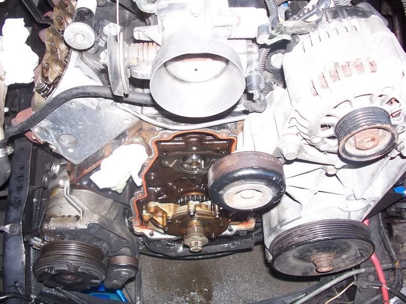

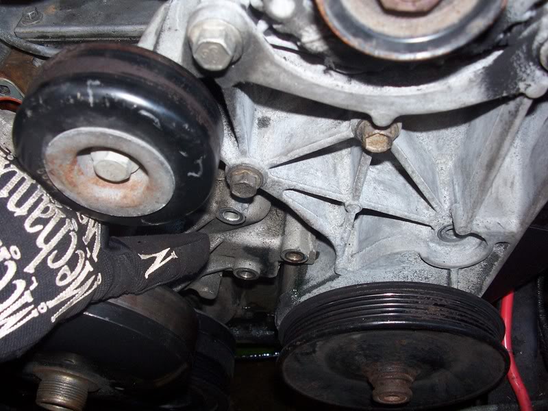

Timing Cover went bye-bye (10 bolts there)... Along with pulley, cam gear, chain, & block plate that holds in cam... sorry no pics of that being removed individually... sped up in the interest to save boredom (sp?).
