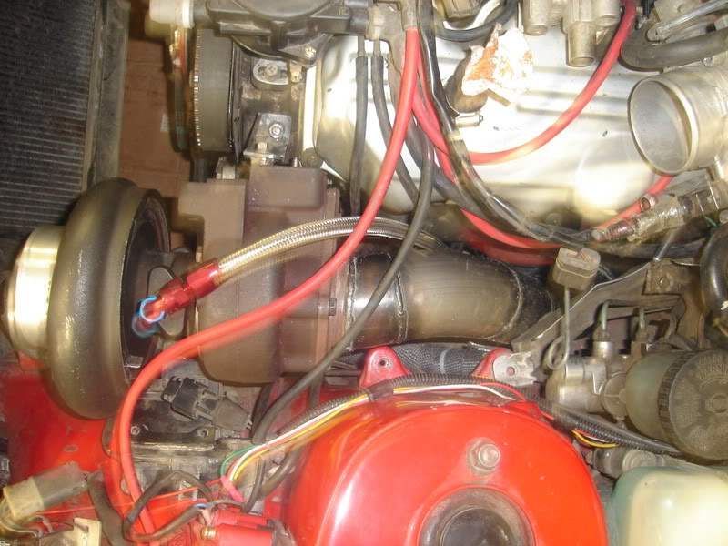

Yep, they came off the Dodge Diesels. I didn't really believe they were putting them on imports until I saw the pics!
