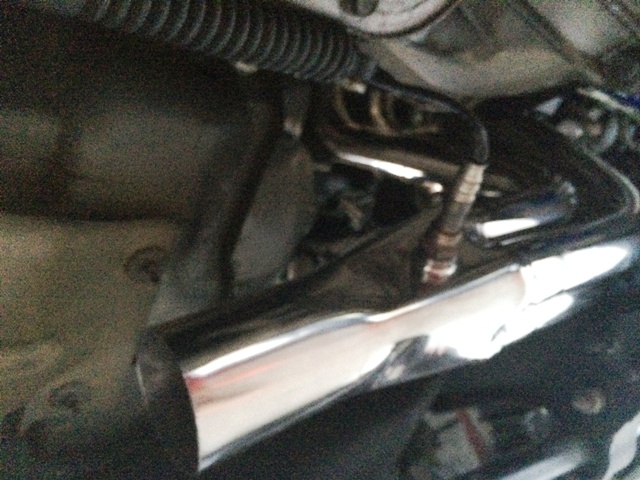

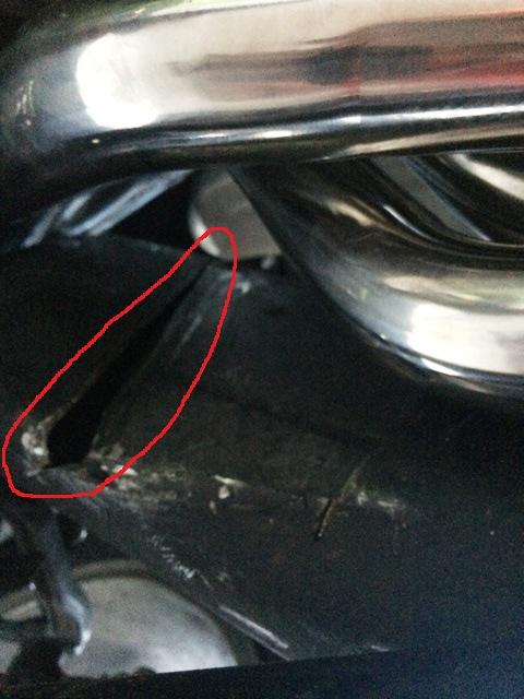

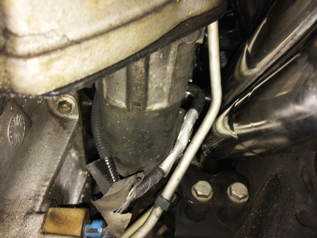

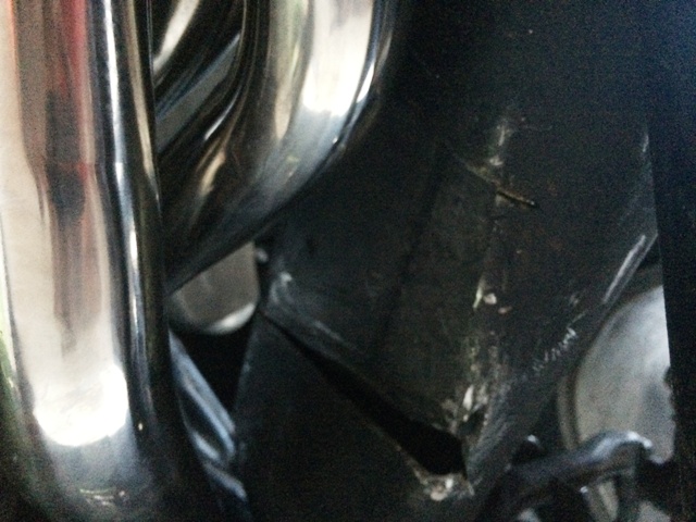

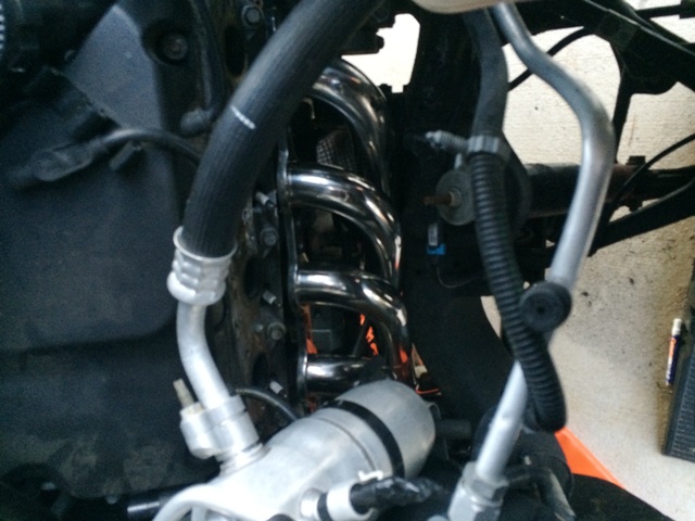

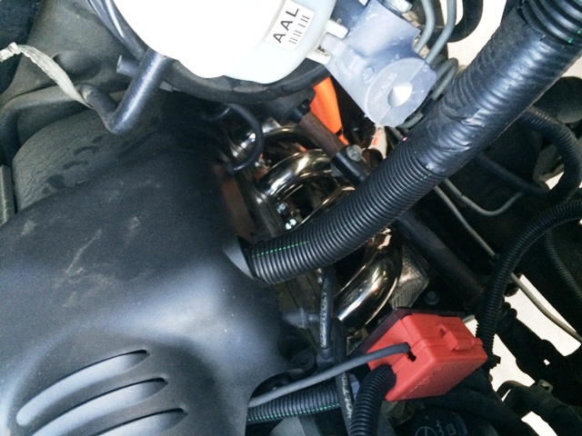

Here are some pics so far guys.
Attached Thumbnails TSP F-Body 1 7/8 LT's on a 2006 ISS-img_0561.jpg   TSP F-Body 1 7/8 LT's on a 2006 ISS-img_0563.jpg   TSP F-Body 1 7/8 LT's on a 2006 ISS-img_0564.jpg   TSP F-Body 1 7/8 LT's on a 2006 ISS-img_0565.jpg   TSP F-Body 1 7/8 LT's on a 2006 ISS-img_0568.jpg

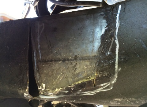

So this is the part of the frame that was cut/modified to fit the header? Do you have any better pics of this area? It's hard to get any orientation as to where this is on the frame etc... Was this taken with the header in its mounted position or is the header unbolted and laying off to the side?

I dont but I will take one today. Yes it was cut with a sawzall and a grinder. Its not perfect but I will clean it up and weld some support pieces in there to clean it up some and make it look better.

Here is a better picture Mike. I still have some trimming to do as you can see by the white paint marks. I will probably cut it again with my sawzall and weld it up before I remount the header. I got all my stock trans lines, fittings & trans cooler out yesterday. I only had one fitting and line to pull today. I mostly had things to do around the garage & for the family.

Aaahhhh that clears it up. Thanks man.
