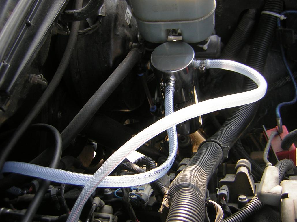

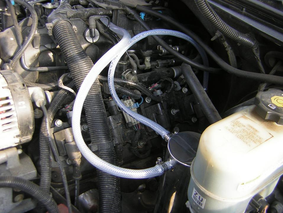

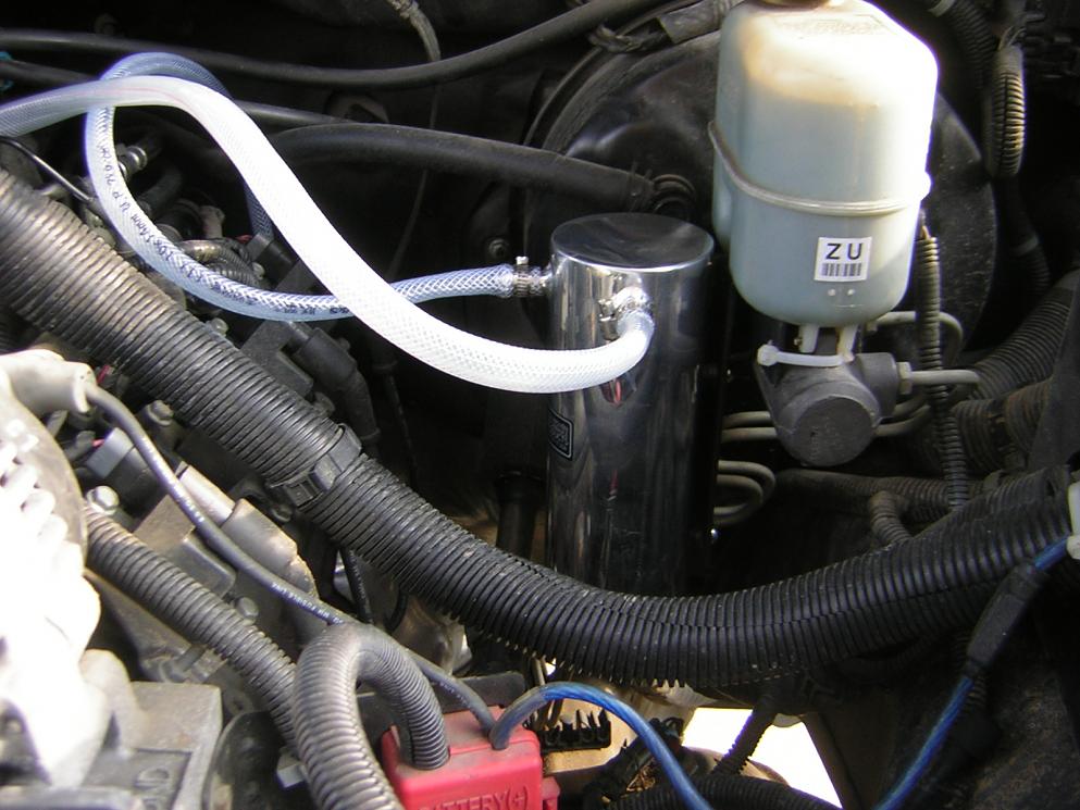

Well here ya go. Right now I have it mounted to the brake fluid res. with zip ties. I will eventually mount it with a bracket or something. As far as the hoses go, the ones that came with it are fairly soft. They kind of compress due to the vacuum. Think its a must to get some stiffer lines? The hose that originally came off the pcv valve was steel wrapped in foam.

Definitely ditch that hose, looks like it will collapse under vacuum. Some good rubber fuel line style hose should do the trick.
BTW, even with the oil catch can, you will get some carbon build up in the throttle body, it's just a by product of the induction system, especially if your truck is equipped with EGR. But even without EGR some carbon buildup is to be expected. I usually clean my throttle body every 12k, or every time I have the intake tube off.
