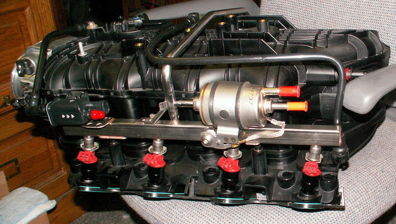

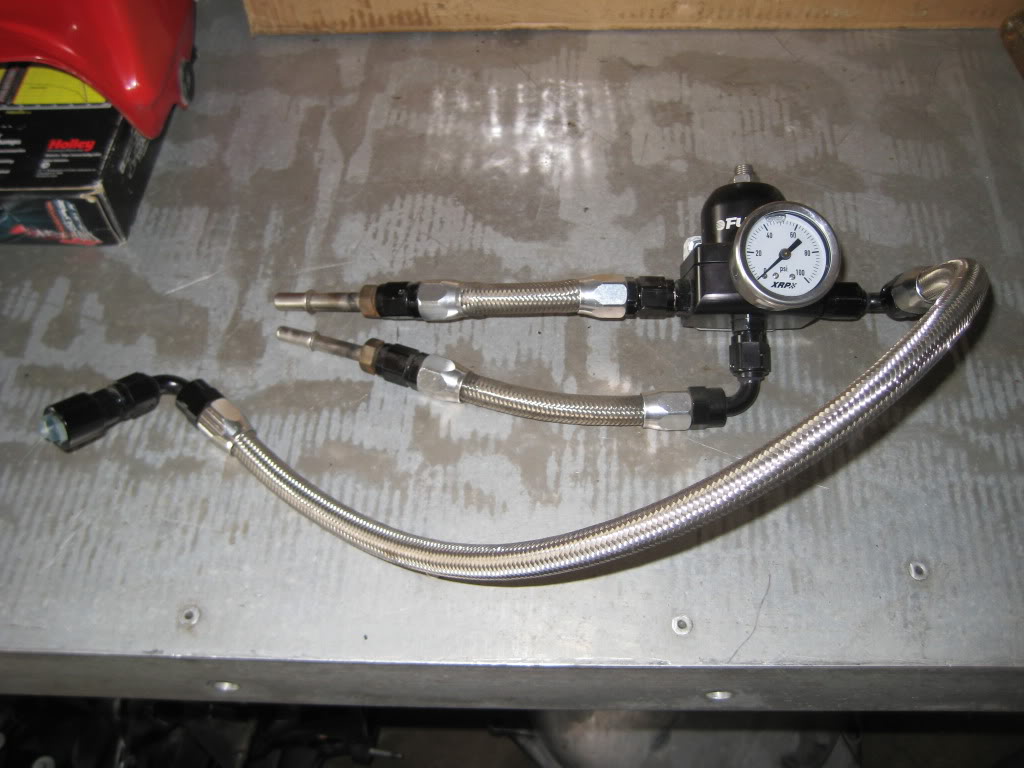

heres some pics i found of a TBSS setup for a 99-02 and the FPR as well

Modifying the stock hard line would be cheaper.
IMO i would run the corvette fuel filter the FPR setup is to expensive i just had the picture so i figured i would post it up

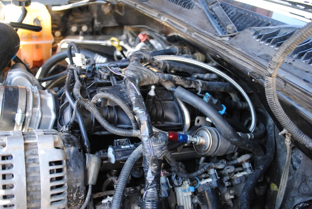

vette fuel filter ftw
constant fuel pressure of 58#

X2 with andy I have the exact same set up and runs like a champ no leaks what so ever and mine moves from 58lbs to 60lbs from time to time

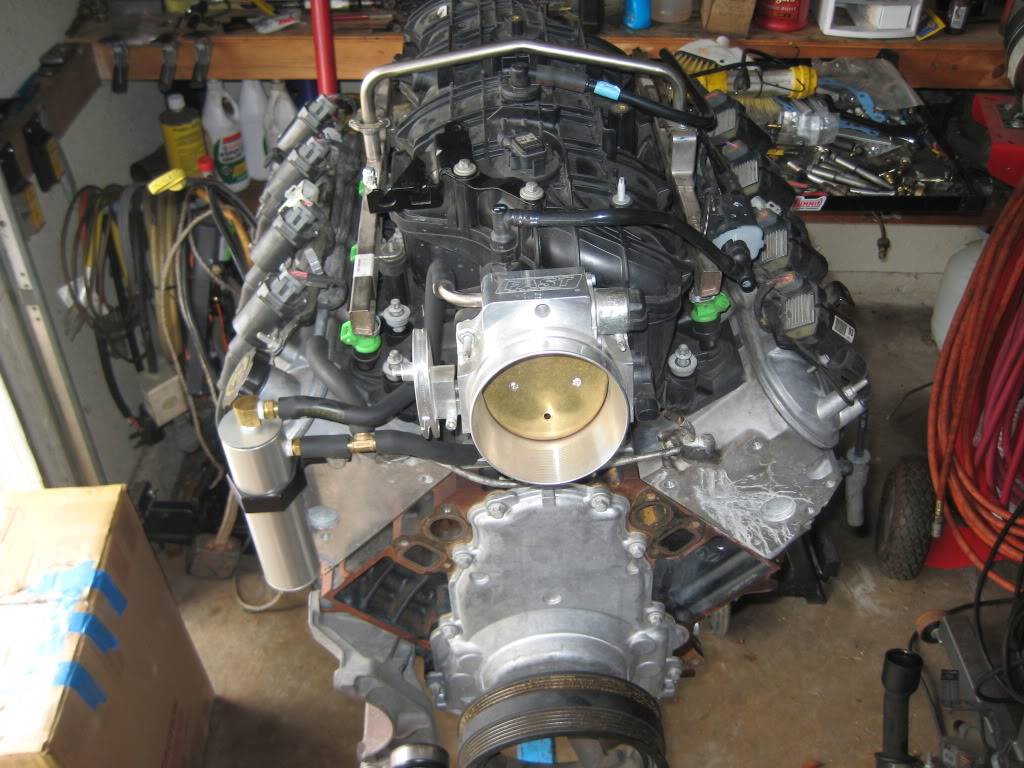

Here are the pics from my setup I did mine alittle different
