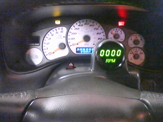

Gtech are useless
get a tach and see where it really spins to, get something like this

Post
Does anyone else make a different type of pod? That design is ok, but it blocks the dash view a bit, and isn't all that sporty. IMO
