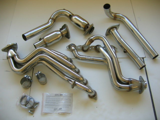

OBX Headers 99-05 Chevy 2500 Silverado Suburban 6.0L V8
HEADERS AND CATTED SYSTEM! INCLUDES HIGH FLOW CATS!
on Ebay for$695.
*Non-Sponsor ebay link removed*
Please refrain from posting direct links to non-sponsor items, thank you
