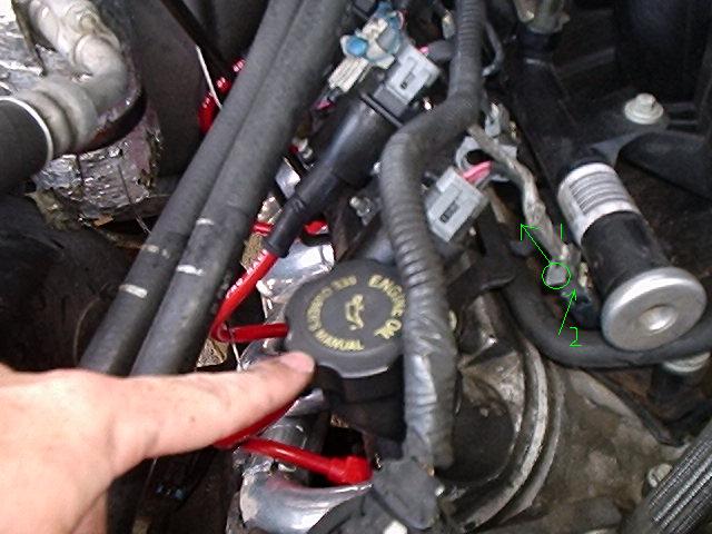

in that picture for example, can you see the injector harness plug or no?

i see but how do you use it, does it insert all the way in then you start screwing it out or do you screw it in and un screw it or what, im not really with it right now, my mind is all fuzzy with pissedness

I circled the two injector plugs that are visible.
They can be tricky to unplug unless you've done it before. Pull the gray tab up, and the whole gray plastic piece will slide up the injector wiring. You don't have to pull all the way out. If you get it to a certain point it will push against a plack tab on the actual connector itself, that is what releases the connector from the injector. If you pull the gray plastic piece all the way out you will have to get in there and release the black tab on your own.

See if this pic makes sense of what I just said.
