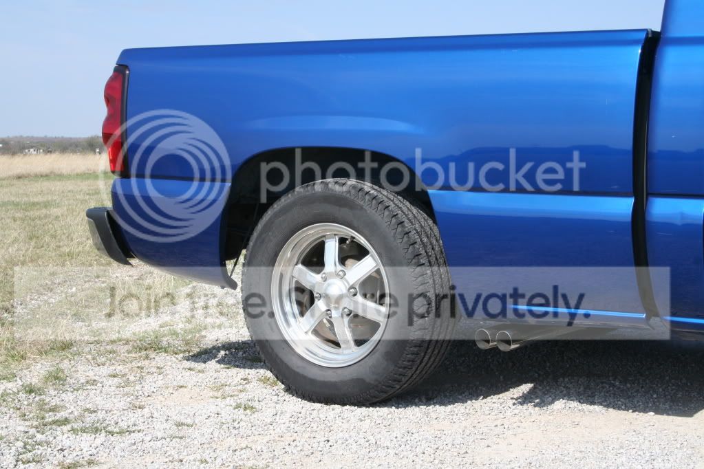

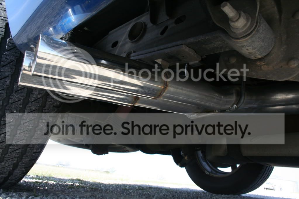

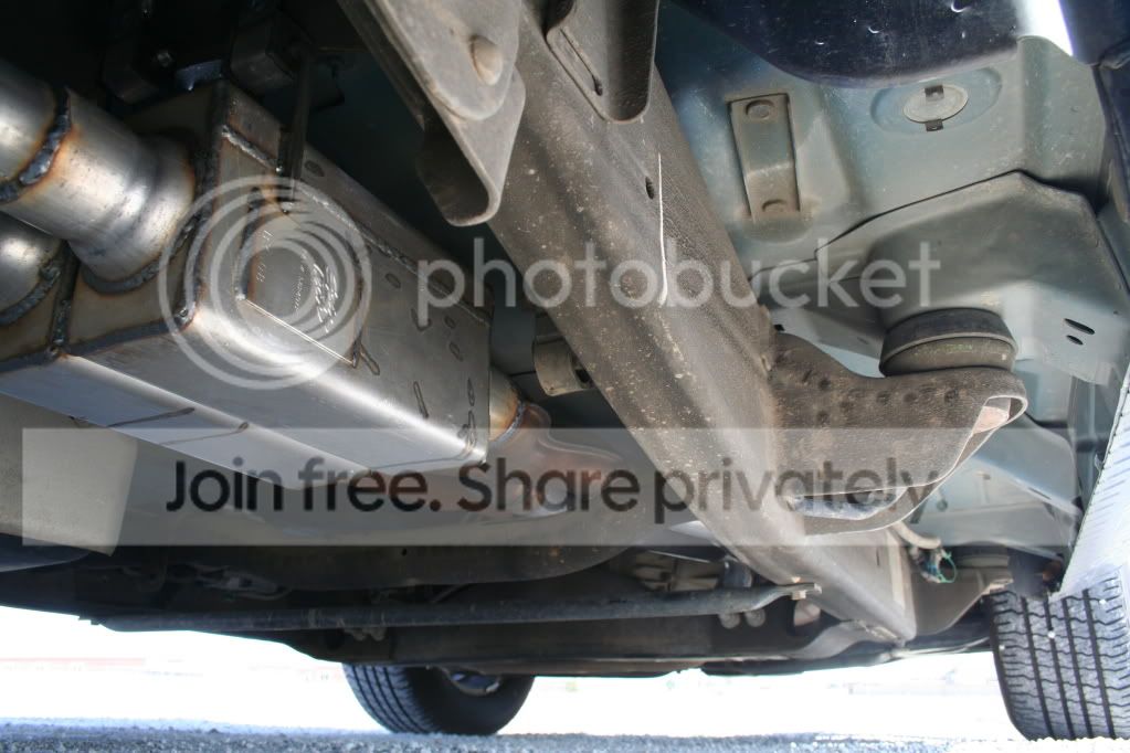

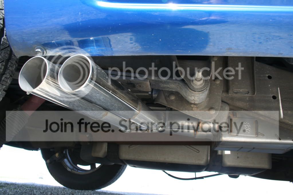

It's kinda hard to see from my pics, but I basically had the 'y' portion cut off and had the shop weld in my x-pipe right where the two collector pipes come together. The pipes just went side by side there on out.
You can click the pictures for bigger versions, too.
