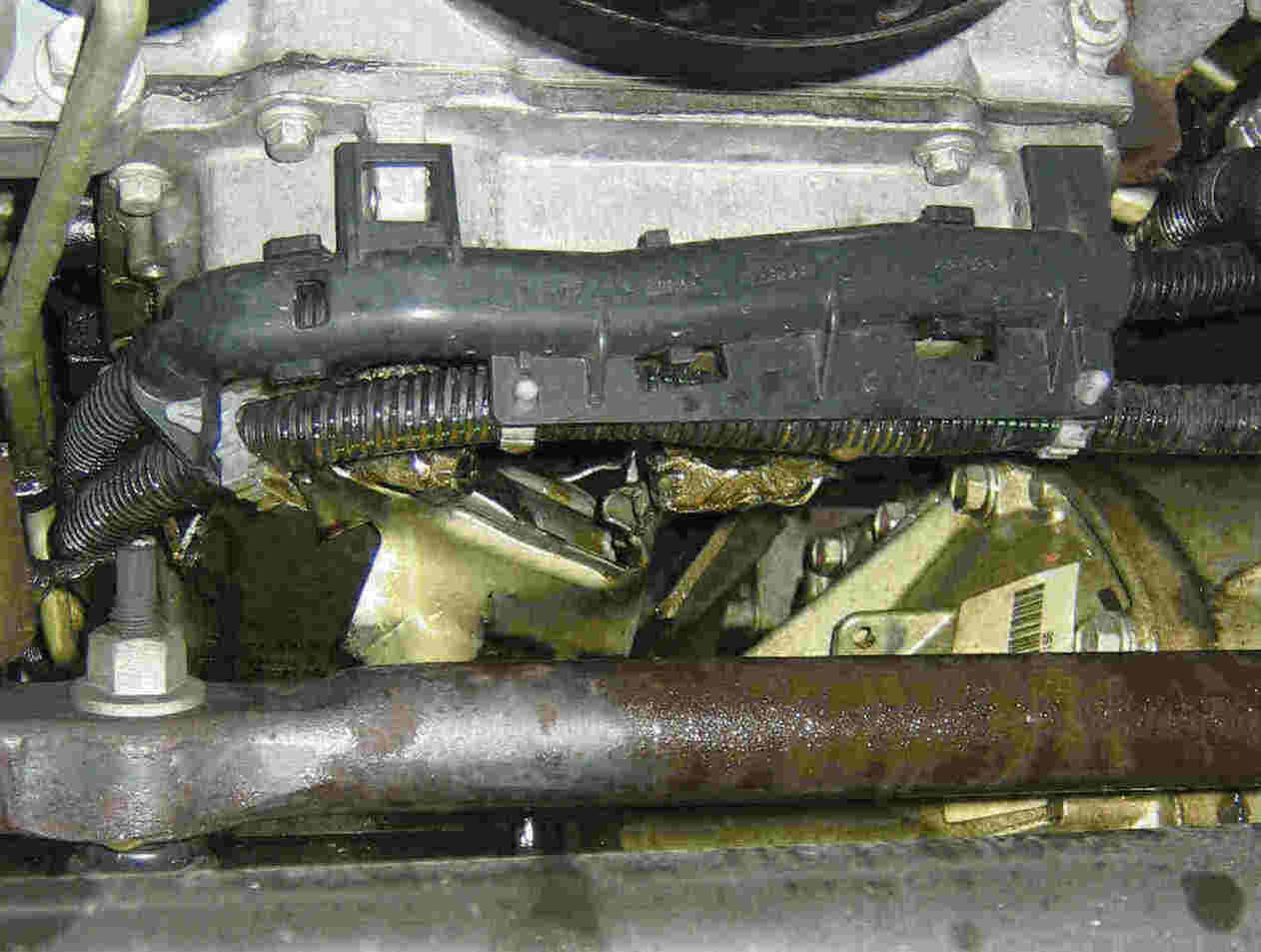

Sometimes a man doesn't know his motor's limitations. This is one of those times.
The motor made a couple of thumps as I was coasting down to legal highway speed after a 60-90 mph blast. It almost seemed like a tire went down.... but then I got the check engine light.... and then a low oil pressure warning script across the driver info screen.... and, finally, I was coasting down in a whole other way.
See pics for what happened...
Here' s some math thrown in for fun-
2am + 6 miles from home = $100 tow bill
((Radix at 9 psi + cam) - big hole in oil pan)/ 10,100 miles = no warranty
LQ4 with 2 broken rods = front timing cover, oil valley cover, maybe rocker arms, and flex plate are the only reuseable parts from entire engine.
I'll think of some more witty stuff later, I'm sure.
Attached Thumbnails Radix Uber Alles-bottom-view-1.jpg   Radix Uber Alles-piston1.jpg   Radix Uber Alles-radix-uber-alles-1.jpg

AH, that really sucks man! I hate it when a motor fails the oil pan test! (i.e. oil pan fails to contain parts inside)

Wow. You sure showed that LQ4 who is boss Sorry man. That sux. What are the plans now????

plan is for more cubes... less boost New heads, but most likely not the WCCH heads. Not pleased with Mattrems results at all. It'll come together fast because holidays are coming and I want it done before then.

I'll have some more pics once I get the engine out... those piston pieces are what I found laying inside the front edge of the pan... LOL
More horrors await.... Muh Ha Ha HA!

How much boost were you running? What are your cam specs?
9 psi and the LPE GT2-3 cam
