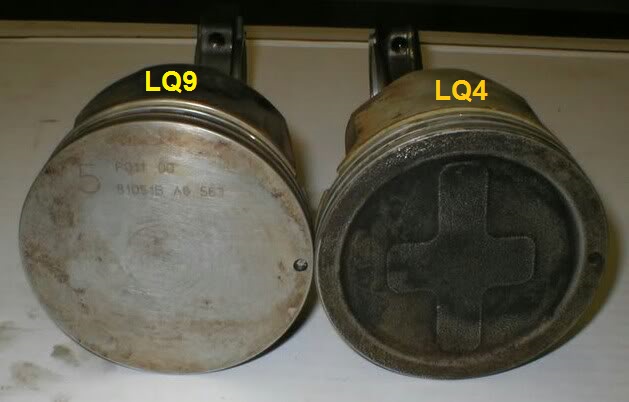

The LQ4 has the dished pistons, should be good to go.
