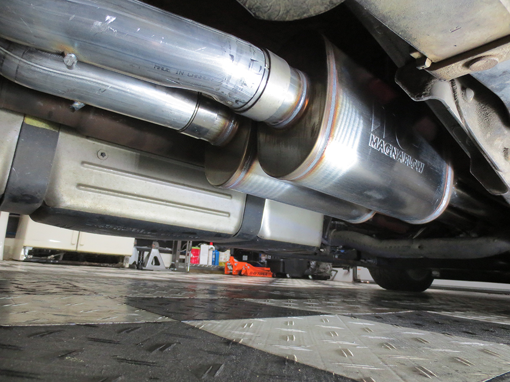

Unless the exhaust on the truck is in bad shape I'd just save up for the Speed Engineering true duals and the LT's you mentioned. I'd recommend the over the axle duals instead of the dumps (really to loud). Your question regarding single or dual mufflers... with two mufflers vs one muffler you'll have twice the muffling capability with two. The muffler lengths will determine the loudness.
Keep in mind the Borla ProXS is a straight through design packed with acoustic materiel for sound control. After installation they'll be at their quietest, then after a few weeks/months they'll get louder after some of the packing is "broken in" (burnt/blown out). I went with a pair of MagnaFlow (12219) fourteen inch mufflers behind the SE dual kit. At first they were really quiet almost to quiet! Now they are perfect for how I want the truck to sound. If I'd have went with the dual 18" the truck would be to quiet IMO.
If you decide to go with dumps or exit in front of the right rear it's gonna be louder than with tails exiting out the rear... you may want the longer mufflers.
The Speed Engineering (Chinese) mufflers are really pretty with the polished cases but mine started rattling after six months sounding like **** lol. Just to add... the over the axle SE tailpipes will not fit with a 4/6 drop as the space is just to small, had some tailpipes made.
What ever choice you go with... do yourself a favor and buy the Torca AccuSeal clamps. The clamps that come with the Speed Engineering kit are total junk
