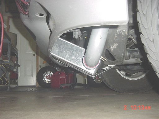

Originally Posted by 2toneblown
what do you mean 45 degree angle
It goes from behind the airdam down on a 45 degree angle to the front crossmember.
Heres a side view.

That looks like it hangs a little low. I dont want mine hangin below the bumper, but if i dont have a choice then o well i will then. I wonder if i could get one that would fit in the grill somehow.
