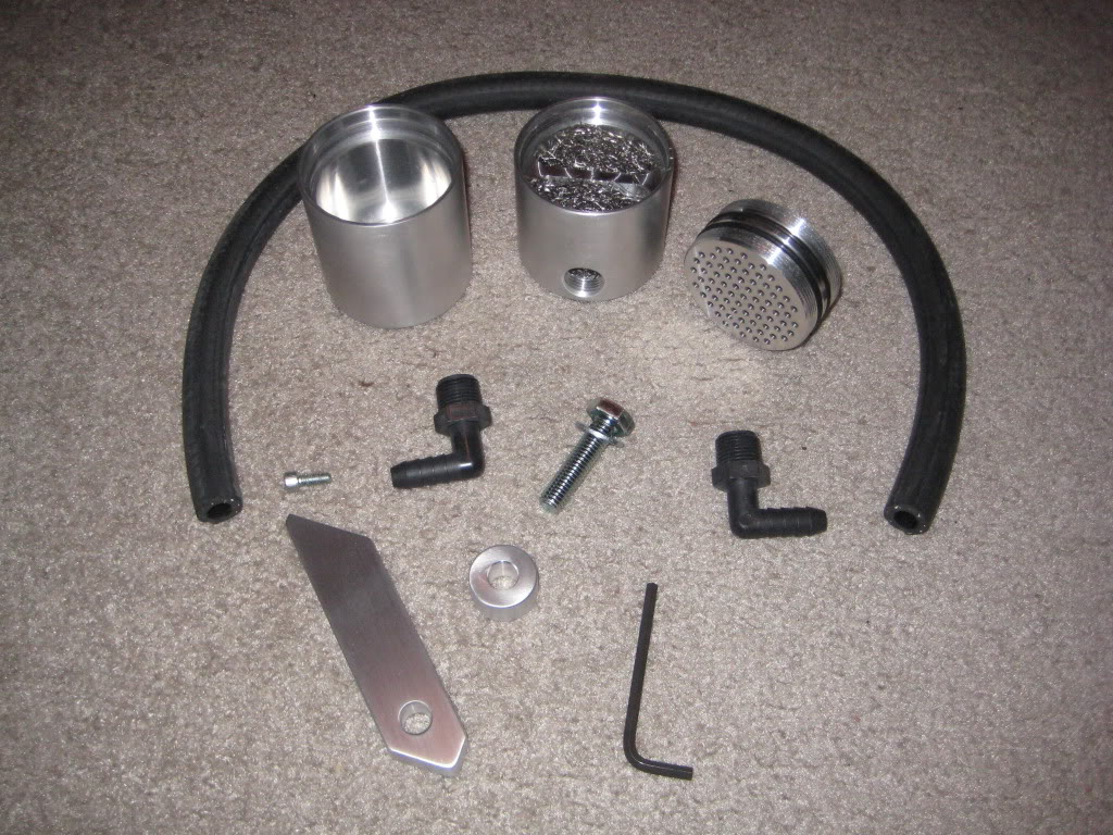

Here the can is disassembled...
Plugging the PCV and taking off the oil cap, I do get a bit of smoke out the oil fill @ idle. However, w/ this much oil collecting in the can, I would think I'd be re-filling my oil every thousand miles or so, which has not been the case...or I would see some noticeable smoke when driving daily.
As mentioned, the can is installed in the PCV to intake line. Can is mounted on the pass. side of the block in an existing front hole and lines are run ti it from the fixed orifice PCV (non-ball type) on the rear of the driver side head to the barb on top of the intake. Sorry, no pics at the moment, but each line to the can is ~3' long FWIW.
