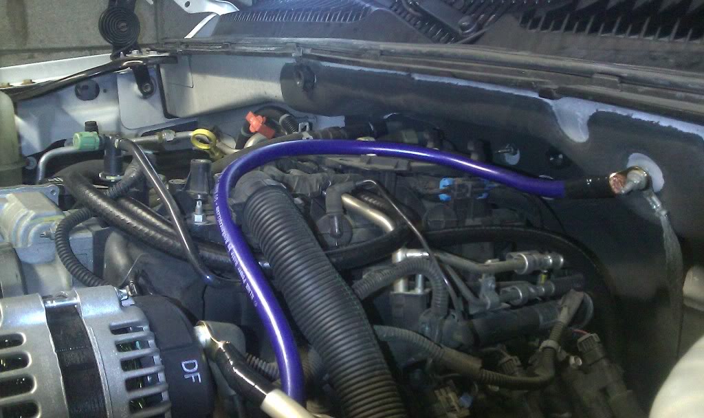

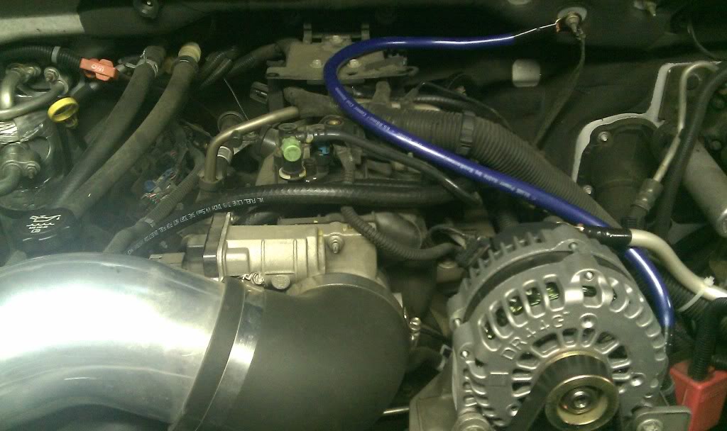

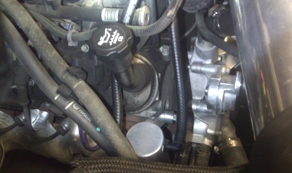

If you look at the first pic on page 1 in this thread, you see the stock plastic tube running from the pcv valve on the rear of the driver-side valve cover to the top of the intake. I removed this and did this: (sorry for the crappy cell phone pics)
You can make out the black rubber tubing leading from the back of the d-side cover across the front/top of the intake (under the vortec cover) and over to the pass side, where the catch can is mounted to the front of the block.

Looking down at the can, the right side is the inlet, left is the exit. The can I got appeared to be bi-directional.
The tubing exits the can and goes back over the top of the engine and attaches to the intake where the stock plastic hose was disconnected from. I can not see anything wrong w/ this set-up and am still baffled as to why I am filling the can so fast. Could the 3' runs of hose be creating some abnormal vaccum? I don't see how that's possible, but you never know...
