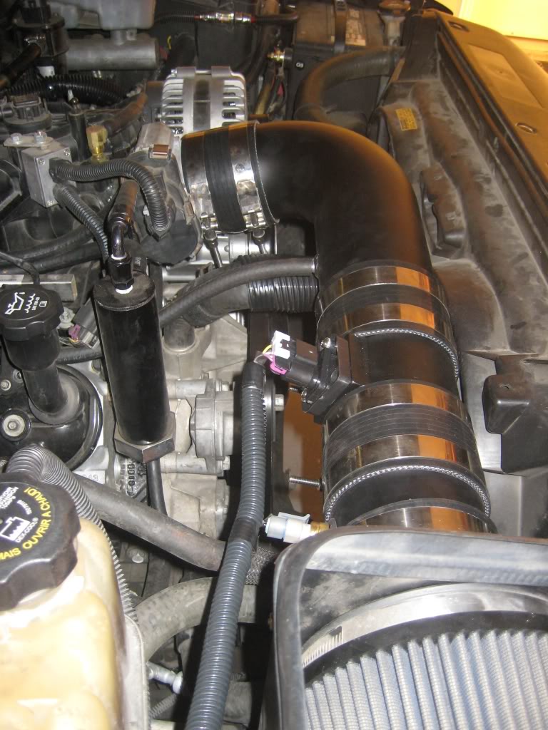

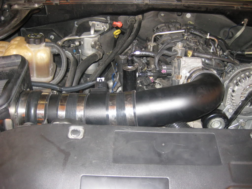

here is mine... the catch can is between the manifold fitting and PCV fitting, which is where you want it.. You don't want any of it vented with a breather if your running a MAF... Also I have the fresh air inlet (Passenger side valve cover) after the MAF which is where you want it. I have the hoses tucked behind the fuel rail so they are out of the way.
you can see both in the picture below.

Originally Posted by lownslo
I Have the oil cap vented through a filter and catch can, but that should be closed off and just have the pcv vented if I am reading correct......
You can have it set up that way, but certain things in your tune may need adjusting to correct for the new air entering the engine. Since your truck has an aftermarket cam you probably didn't even notice the difference in idle, but with a stock cam a PCV vacuum leak would be very noticeable.
I would put the vacuum line back on the intake and valve cover and put the oil filler cap back to stock. I would add a catch can though...IMO, all LS based engines need a catch can on the manifold-valve cover vacuum hose because it is poorly designed and allows oil to enter the intake.
