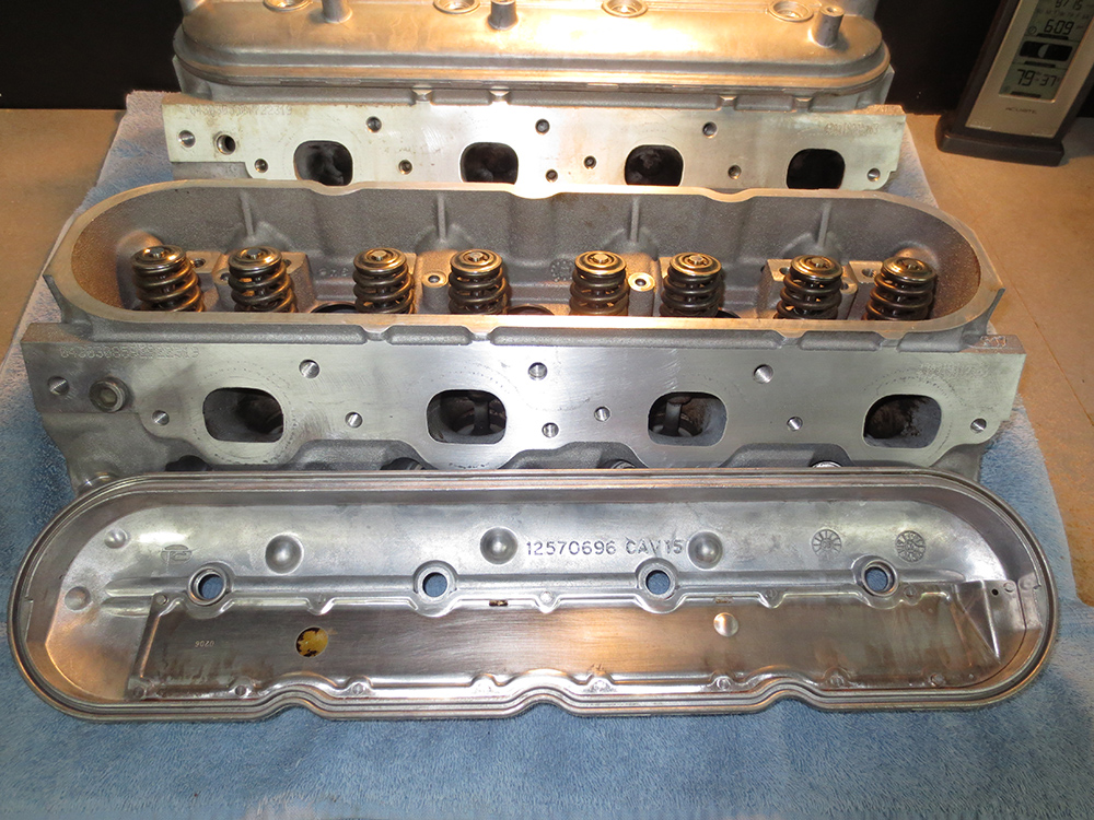

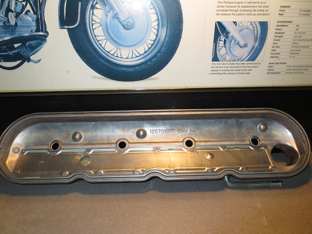

Originally Posted by firebladeJJ
I did notice(i'm just now thinking about it) that the engine did idle much better when i had the pcv on the driver side opened to the air, i didnt seem to struggle as much. I wonder if the much newer pcv on this valve cover is just for the gen 4 engines, not gen 3 stuff....
Worth looking into.
My 2005 6.0 (GEN III LQ9) doesn't have the replaceable PCV valve on the drivers side cover (or anywhere) just a nipple to connect the hose from the intake. I'm running the OEM PCV system, no catch can with a 228/230 cam. I have zero issues with oil consumption or smoke. It's been a year since the build, rings, bearings, oil pump etc.
My 2005 valve cover part numbers are drivers (12570696) and passenger (12570697)
Driver Side
Pass Side
