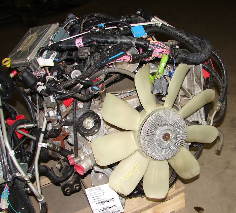

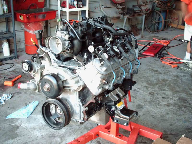

You need the engine of course, the motor needs to be turn-key.
turn-key means 100% ready to bolt in and fire up. It needs to look like this
Attachment 138390
Attachment 138391

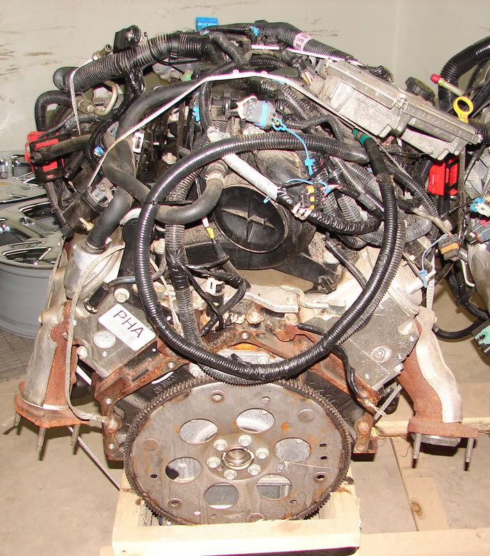

It needs the wiring harness from a V8 Silverado, if you have a 99-02, get that harness if your motor is 03+ be sure to get a harness for an 03+ reason being the 99-02 models have a drive by cable throttle body and the 03+ models has the electronic throttle body.

PCM- AKA the computer- The V6 PCM is the exact same externally as the V8 PCM the only difference is the tune or program that is written to the PCM. So you will need to have your V6 PCM reflashed and tuned with the V8 parameters. I would recommend Nelson Performance. Nelson Performance
Allen will send you a PCM tuned for your new motor and mods in which you have installed. The tuned PCM will also be tuned for the V6 Vin # so everything will fire up on the first try if everything is hooked up correctly. Once you receive the new PCM simply send Nelson Performance your stock V6 PCM. Nelson Performance is not the only option, there are some other options such as custom DYNO tuning or other mail order tuners. Just be sure to ask whoever does the tuning if they can indeed reflash the V6 PCM with the V8 parameters and V6 vin.

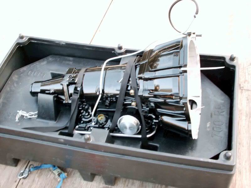

Transmission- The V6 transmission will bolt up but it will live a short life behind the new powerplant. I would recommend purchasing a built unit from a reputable Transmission shop such as FLT (Finish Line Transmissions) Finish Line Transmissions | Performance Transmissions | Torque Converters | Transmission Parts | Transmission Service
FLT builds flawless units everytime and they dyno test them before shipment. Chuck or Vince can recommend a specific model for your needs.
Note: the stock V8 unit will break just as fast so get a good built unit that will suit your needs.

Flexplate- You will need a 4l60e flexplate from a V8 motor, a stock one should work fine.
Note: If you purchased a 6.0 and it has a flexplate on it already it probably will not work because the engine was most likely mated to a 4l80e transmission.

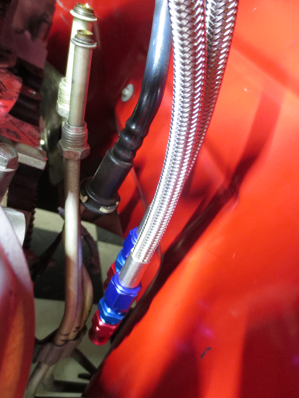

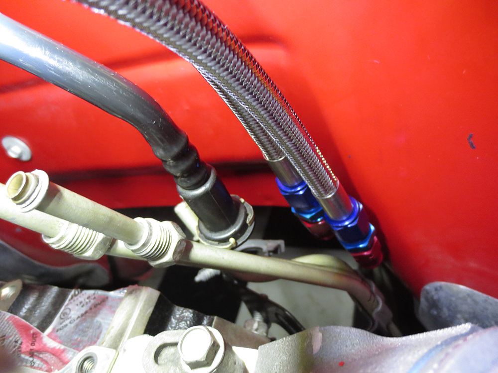

Fuel Lines: The stock fuel lines will not work with the new motor, you will need
2 EAR-165056ERL -6 - 5/16 AN to tubing connectors Male end
2 EAR-165006ERL -6 - 3/8 AN to tubing connectors Male end
2 RUS-658490 1 ft sections of pre assembled 5/16 Steel braided hose with female ends
Simply attach one 5/16 to -6 tubing connector to the fuel rail on the intake manifold
Then attach the 3/8 to -6 tubing connector to the return line on the fuel rail on the manifold the above PN#’s are from Summit Racing
Cut the fuel “tubing” about 6 inches below the firewall and follow the same steps as above. Now attach the hoses to the fittings which are now on the tubing. MAKE SURE the fittings are on snug! Now when the time comes to hook up the lines simply screw on the lines to the manifold.
Note: be sure to label the lines, Fuel and return. Fuel being the larger line and the return the smaller in diameter.
Attachment 138390
Attachment 138391

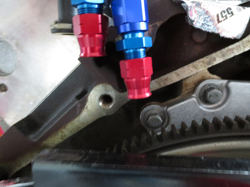

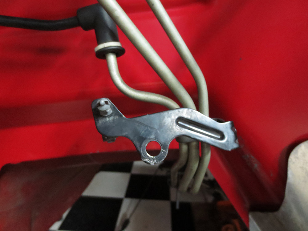

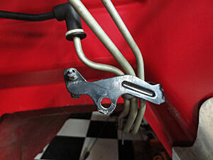

The OP says to cut the fuel lines 6 inches below the firewall (maybe he meant cowl). This is kinda ambiguous to me. If you were cut the lines six inches below the firewall you cut off the fuel line mounting bracket that attaches to the bellhousing stud and the lines will be to short.
I set the intake with the fuel lines on the motor to see their relationship to that bellhousing stud/bracket. I think if I cut the lines just above the bracket I'll be close... thoughts?
I've got some space to get in there and cut the lines now. Doesn't hurt to have a background in body/paint/collision (retired)

Did a quick test fit with the engine to see where I need to cut the fuel lines. There is a bend in the lines above the mounting bracket. I think I'll slightly straighten the bend then cut just above where the line is straight enough for the union. It looks like the evap quick connect will also fit once the line is straightened. It feels good to finally see the 6.0 between the frame rails even though its just a test fit.

granted it's been 9yrs, but i think i carefully popped them out of the bracket to separate them enough because i do remember using one of those little tubing cutter wheels that you tighten & roll around it until it cuts through.
