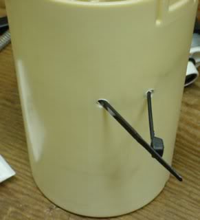

Here is what is required to install an aftermarket intank pump in 99-02 return style sytems. The particular pump I used was a Holley #12-914 255LPH. Approx. install time 2.5~4 hrs.

12.The bucket will have to be modified at the bottom so the pump inlet will go through the bottom far enough to install the filter sock. (I used a dremel tool) see pic #1 below.
13.Then I had to modify the bucket so i could secure the pump. See pics 2 & 3 below.

16.I went ahead and routed the zip-tie through the bucket before dropping the pump in.
17.Now drop the module and pump back into the bucket, making sure to clip both clips on the bucket.
18.Insure that the pump is all the way down and secure it using a zip-tie already installed in step 16. You can also install the filter sock now.

Pic 1
Pic 2
Pic 3
