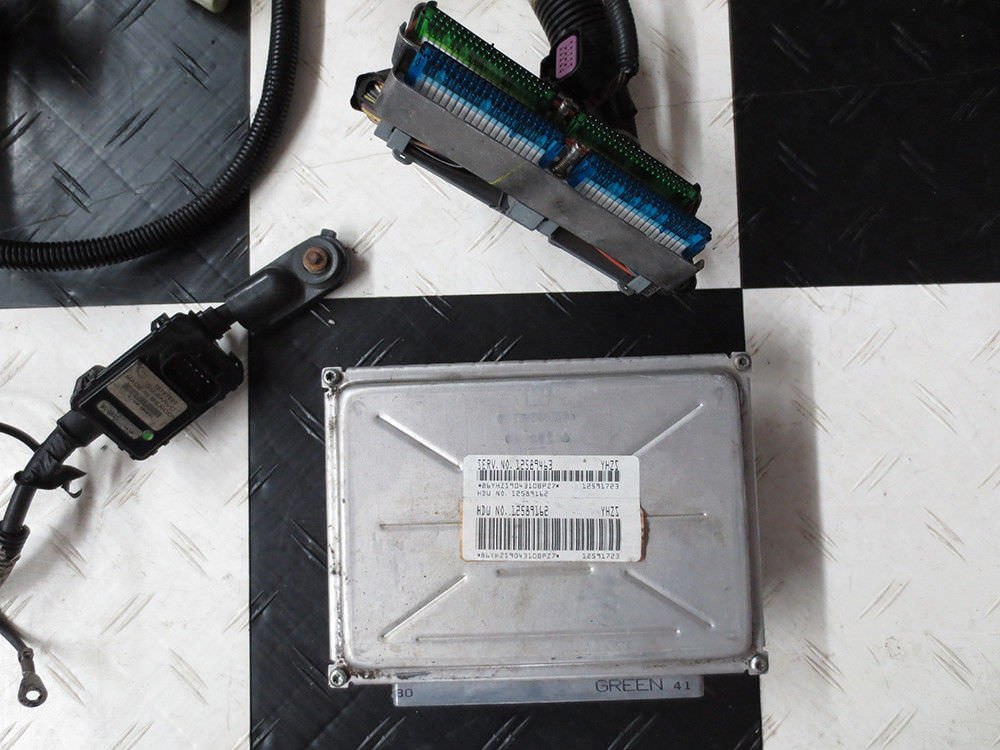

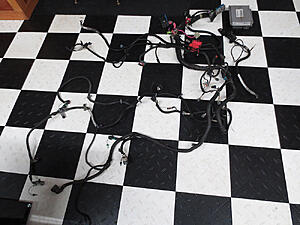

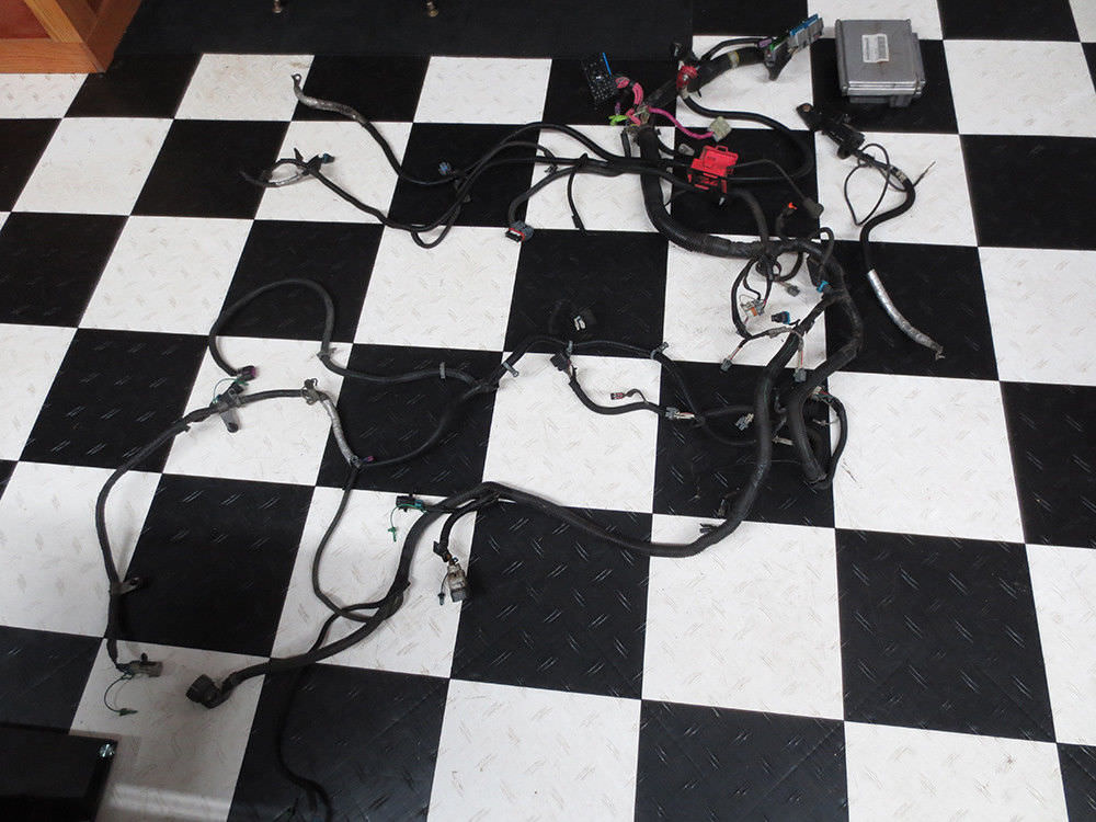

Doing a 2000 GMC 4.3 to 6.0 (LQ9) swap and hit a snag. The donor engine, wiring harness and ECM (12589463) came out of a 2005 Escalade. Just received an e-mail from Brendan Patten from LS1Swap and he confirmed the 2005 harness will not work with my 2000 fuse block.
Originally Posted by Brendon
The 05 harness WILL NOT work without modification. It maybe far easier for you to get a factory 2000-02 red/blue V8 harness, and go with mechanical throttle. Its possible to make what you have work, but can’t even begin to explain pin for pin what needs done. Basically the starter circuits are completely different (includes wiring for park neutral position switch), there are wires for cruise control that need moved around. Wire location for power circuits may need moved. Wouldn’t know without side by side comparison.
If anyone is in the reverse situation and in need of a UNCUT 2003 - 2006 harness and ECU and wanting to swap (or has a 00-02 harness for sale) hit my PM. This is the only issue holding me from completing the swap. I'll list the harness and ECM in the classified section if someone is in need. I also have a used but clean DBW throttle body I won't be able to use.
