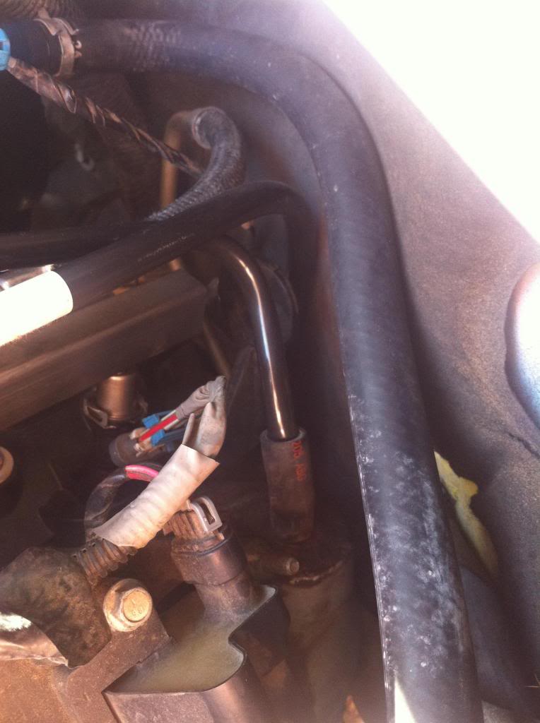

I finally got almost everything together to get my NNBS intake on but there is a piece that goes into the top of the manifold that I didn't get. It's the fitting that the PCV hose from the drivers side valve cover hooks to. Does anyone know the part number for that so I can get it from the dealership? Or another solution?
Here's a picture of the hole where the part goes.

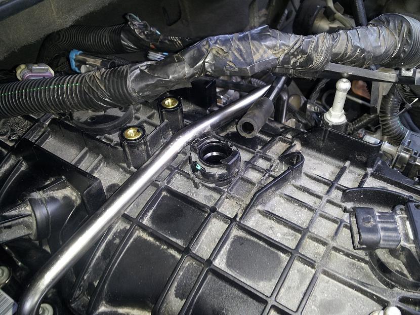

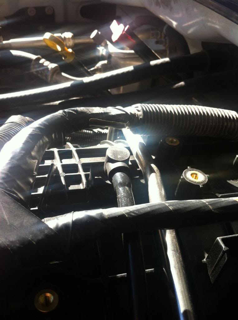

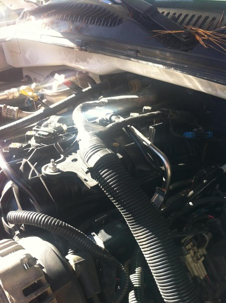

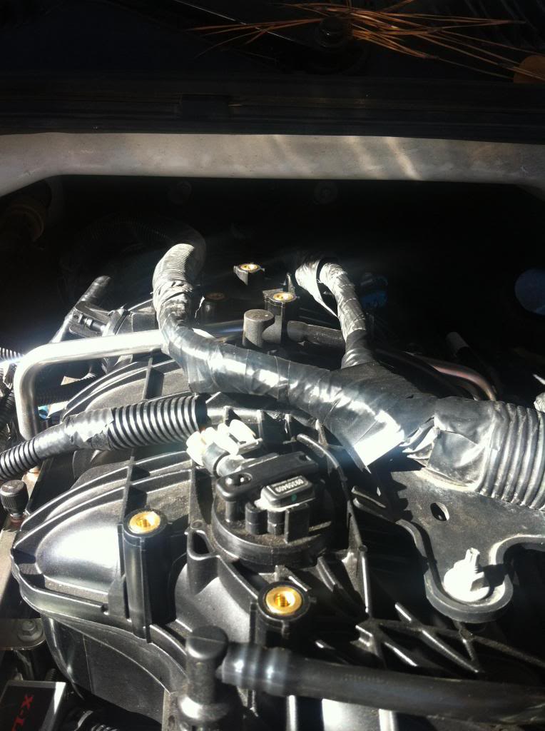

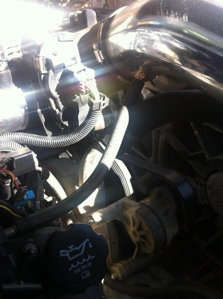

Just go to the dealer and tell them you need the PVC line from an 09 pickup with a 5.3, it's like $11. Chop off the end by the valve cover just above the locking part and the factory hose on the valve cover fits perfect.
