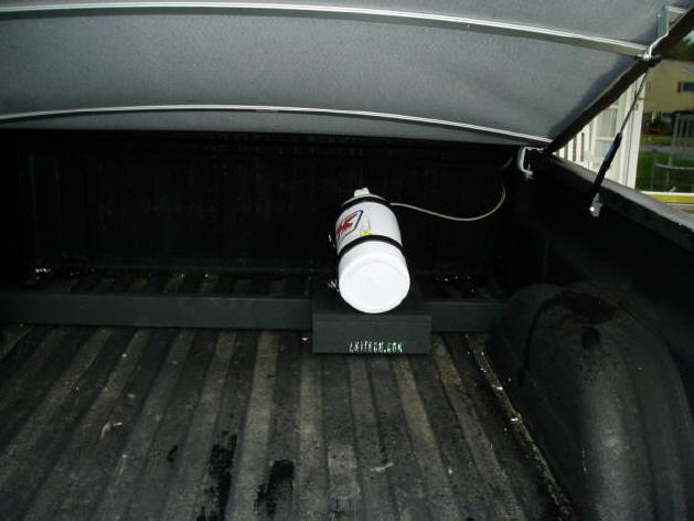

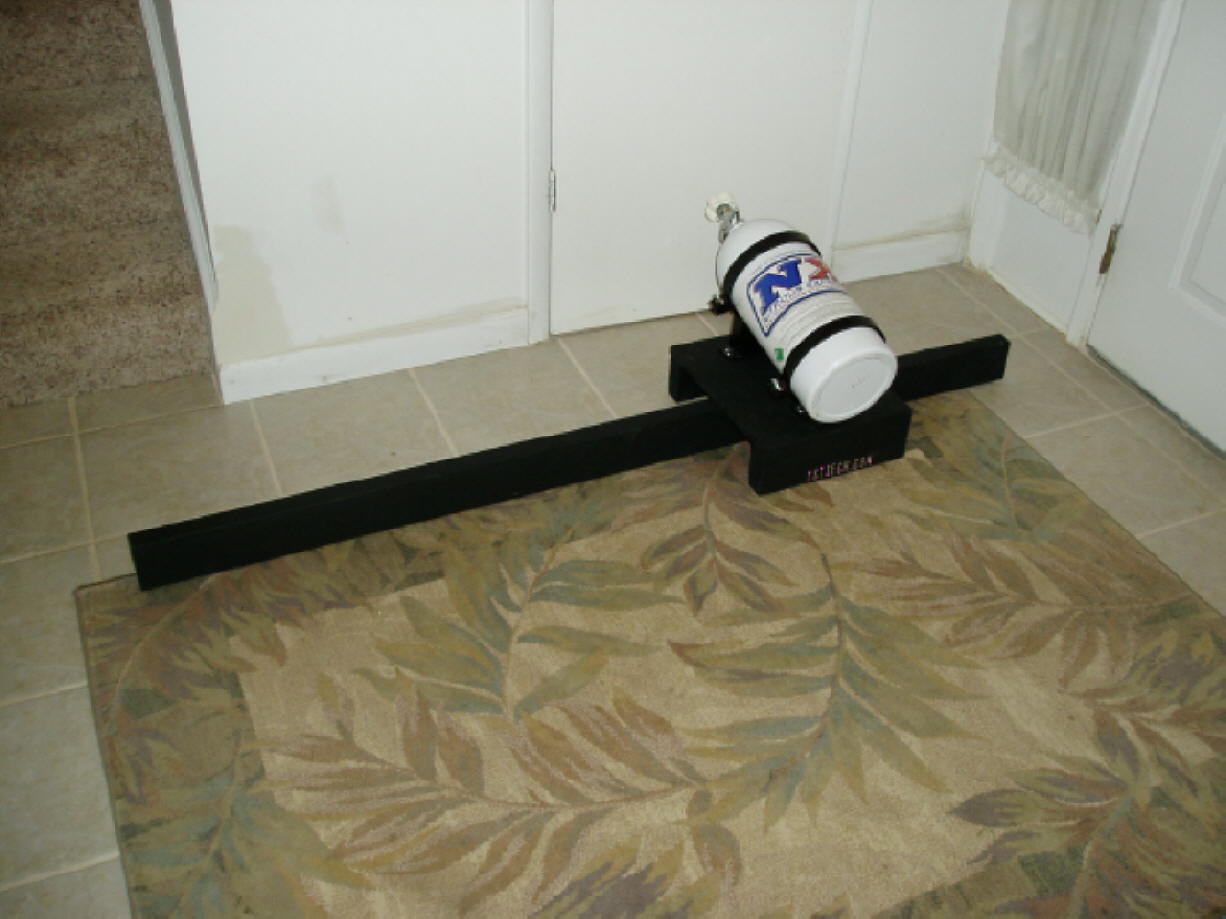

I ran my line thru the hole in the side of the bed that is located near (and into) the stake poket, then down along side the stake poket itself. This eliminated the need to drill any holes. Then I routed the line inside the framerail all the way to the trans tunnel and then up into the engine compartment. I also made a mount for my bottle which slides down into the slots that are in the bed for 2x4's which also eliminated drilling any holes in the bed. See Picture.

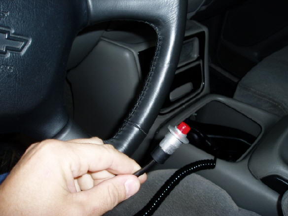

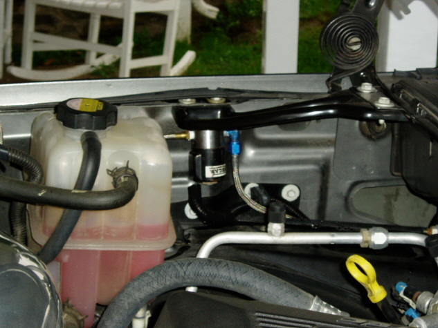

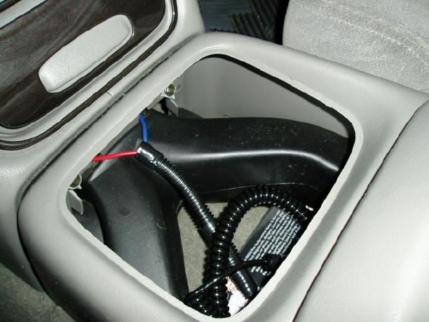

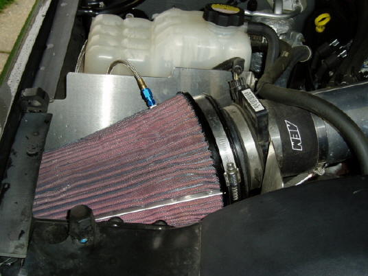

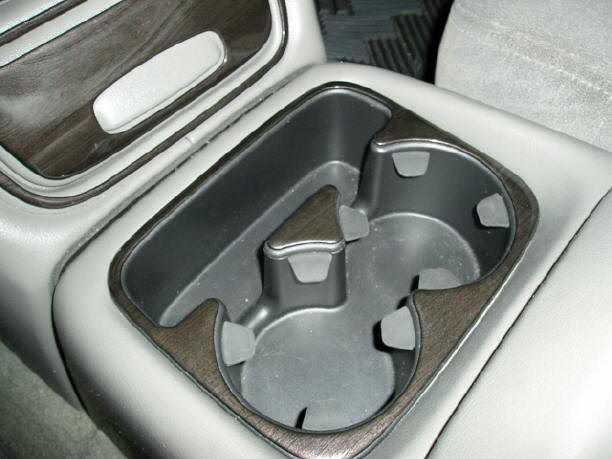

The nozzle is facing down, I didn't include any pics of that part of the install. As for kinking the line, belive me, it's not even close to kinking the line. There is really no need to put any holes in the bed, unless that is what you want to do. Here are the other pics:
Attached Thumbnails nitrous install-filternozzle.jpg   nitrous install-solenoid.jpg   nitrous install-cupholder.jpg   nitrous install-button.jpg   nitrous install-cupholder2.jpg
