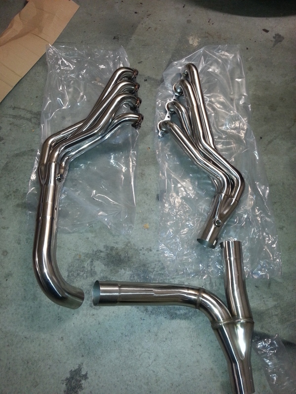

Alrighty, I said screw it, I'll deal with emissions testing when it comes next August. I ordered a set of speed engineering 1 7/8" long tube headers. Saw some pretty interesting dyno results showing 40+whp increases over stock stuff.

Nice pieces. Excited to get it running!
